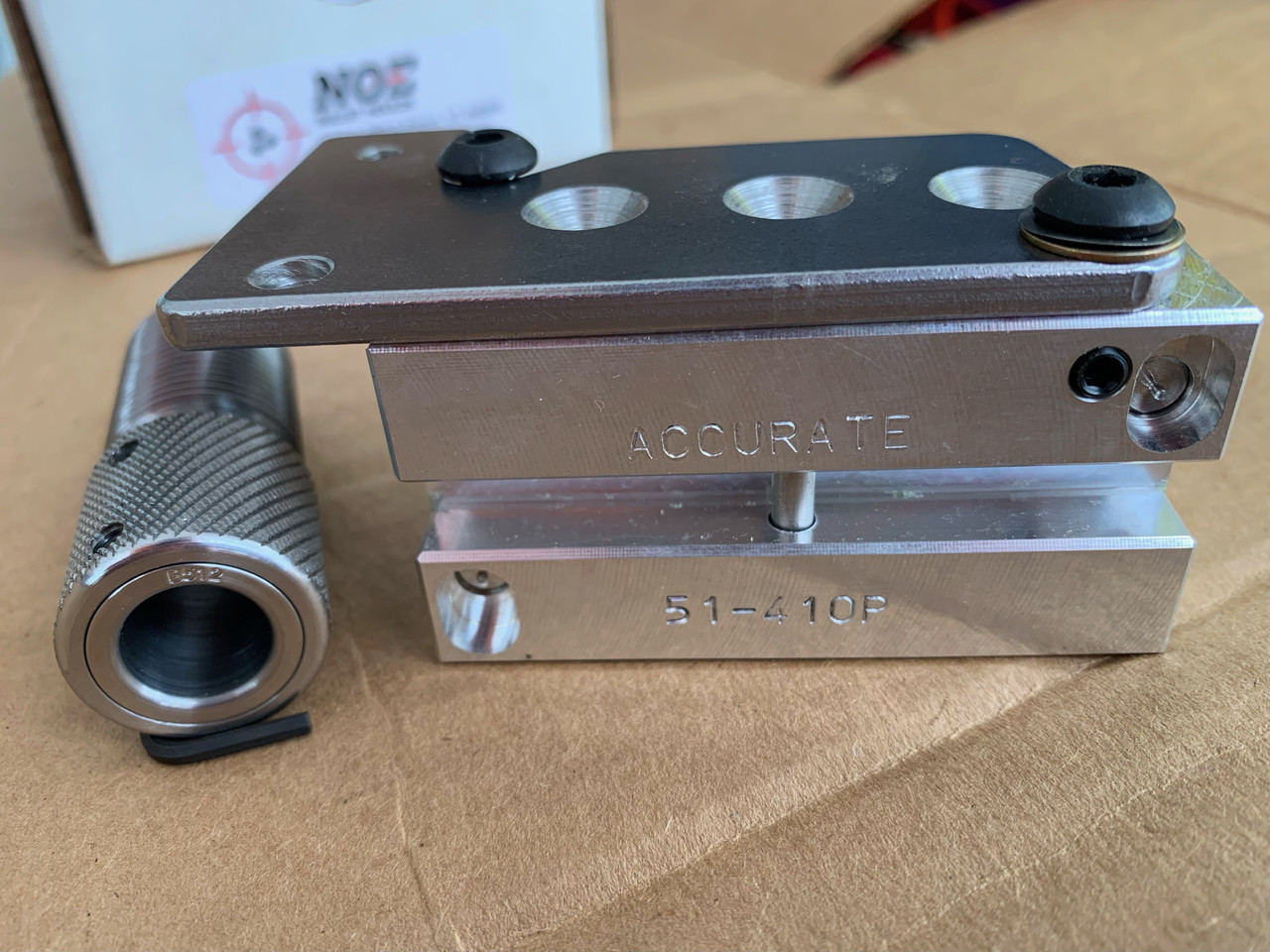

I ordered this one from Accurate a few months back. I haven't cast with it yet, but I expect it to cast well.
I use generally prep new moulds by running a carpenter's pencil over the cavity edges lightly to remove any burrs. Thats more something I would have to do with Lee. I remove the sprue cutter, and color its underneath side, the top of the mould blocks, the sprue pivot, and the alignment pins with graphite.
Then I soak the cavities with lighter fluid to remove any oil. When the mould is hot, but night quite up to casting temperature, I open the sprue cutter and fill each cavity with lighter fluid. If the mould is hot, the fluid will boil. I find this really helps remove any residual oil.
