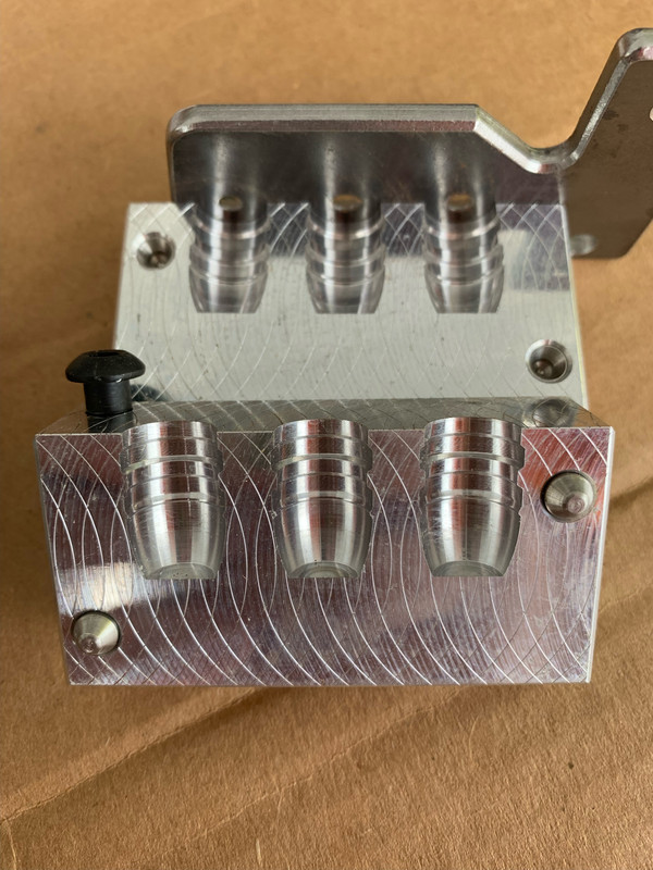

I ordered a 4 cavity mold from Accurate Molds about a month ago and it came in over the weekend. It's an aluminum mold which weighs about the same as a traditional iron 2 cavity mold. I have half a dozen other Accurate molds and I can't say enough good about them. They heat up quickly and when they're at normal casting temperature the bullets literally fall out of the mold. Very nicely made, I like this one, my first aluminum 4 cavity mold so much that I'll likely order others.
I really like and have cast and loaded Lyman's 358156 for years but I wanted a gas check bullet that was not a SWC. From left is a 358156, then Accurate's 36-160G. On the right is Lyman's 358665 which is very similar to the Accurate bullet except that it's a plain base design and has a much larger grease groove.

Ordered one Oct 2nd, hope it gets here soon!!!Walt wrote: ↑Tue Dec 02, 2025 12:20 pm I ordered a 4 cavity mold from Accurate Molds about a month ago and it came in over the weekend. It's an aluminum mold which weighs about the same as a traditional iron 2 cavity mold. I have half a dozen other Accurate molds and I can't say enough good about them. They heat up quickly and when they're at normal casting temperature the bullets literally fall out of the mold. Very nicely made, I like this one, my first aluminum 4 cavity mold so much that I'll likely order others.

Re: New Bullet Mold
I ordered this one from Accurate a few months back. I haven't cast with it yet, but I expect it to cast well.
I use generally prep new moulds by running a carpenter's pencil over the cavity edges lightly to remove any burrs. Thats more something I would have to do with Lee. I remove the sprue cutter, and color its underneath side, the top of the mould blocks, the sprue pivot, and the alignment pins with graphite.
Then I soak the cavities with lighter fluid to remove any oil. When the mould is hot, but night quite up to casting temperature, I open the sprue cutter and fill each cavity with lighter fluid. If the mould is hot, the fluid will boil. I find this really helps remove any residual oil.
