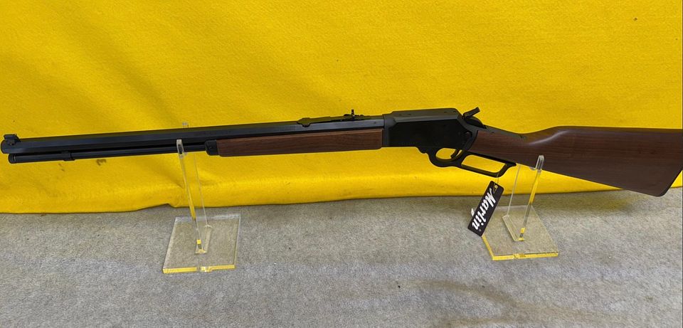

Re: Converting a Marlin 1894 .32 H&R Mag to ..327 Fed. Mag
Photos of mine.
