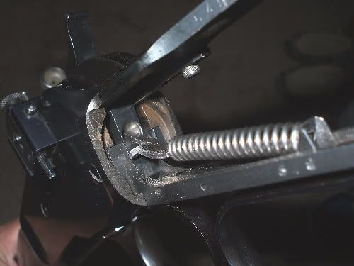

To get it really right you have to install a Browning hammer, trigger spring and trigger. The Browning hammer has a true half cock notch and the trigger and sear are one piece. That way you can eliminate the two piece Winchester trigger and sear, along with the little springs and plunger.
The aforementioned Browning parts are simple drop ins. The Browning hammer is to the left.
The Winchester strut fits nicely in the round recess in the back of the Browning hammer. You must clip the rebounding fork from the Winchester hammer. I also rounded to top fork for a smooth fit.
You have a very positive half cock with the Browning hammer.
Ditto with full cock.
These parts are removed when you use the simple one piece Browning Trigger/sear.
