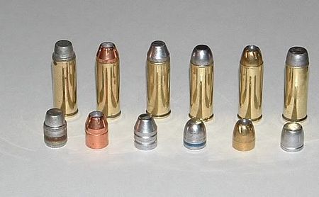

In my Rossis (2 .357s and 1 45 Colt) and in my toggle link rifles (2 1873 and 1 1860), I've found a Round Flat Nose (RFN) works best. Keiths and most semi-wadcutters have too wide of a meplat and cause the straight walled case to hang up during transition between angled on the carrier and horizontal into the chamber. The Marlins & Winchester lever guns, (1892 & 1894) were originally chambered in bottle-neck cases with round flat nose bullets. This aids that transition and makes for smooth feeding. I've also successfully used a truncated cone (TC) nose shape as long as the meplat is no more than approximately a ¼".
The 2 in the center are the best of the lot! Keep in mind, these are .452s for the 45 Colt. The Keith on the left will either catch on the lip of the chamber or jam up against the top of the chamber before it can finish coming horizontal to slide into the chamber. The WFN from LBT on the right will work in a toggle link, but not in either the Rossi or Marlin. If I seat it back in the case further, it will however.

Thanks guys! Appreciate the advice. Photo is very helpful.
