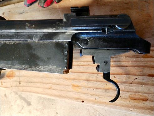

Six, I know you and the other fellas tried to talk sense to me, but I stopped in after work yesterday, handled the mystery rifle and brought it home. It was less than $400, so the sting won't be too bad if she just won't shoot. One of the things that convinced me once I confirmed the bore was excellent was the meticulous inletting job that the builder did in fitting the action into a plain walnut Boyd's sporter stock. The builder also replaced the military trigger with an aftermarket trigger that I can't identify. But it is very good.
Issues include some binding at the rear of the bolt stroke that may require lapping. (A gunsmith friend advises that this is not uncommon where the "duck pond" on the rear receiver bridge of a 1917 has been filled in.)
I have still to measure the rate of twist, check headspace and pour a Cerrosafe cast of the chamber for clues about reamer and throat.
I hope I can get the rifle smoothed up and develop a pronghorn/mule deer load it likes. Will report successes and failures.

Kind of looks like a Timney or Dayton trigger. Let us know how it shoots. Most of my 6.5's including my Swedes have shot well with 160 Hornady RN or 160 Sierra Semi pointed---which I don't think are made any more----they shoot good, only issue is they have the ballistic profile of rock...HA, not a long range bullet.

I've paid more then $400 just for triggers.......check your twist with a tight fitting patch, a Sharpie, and a ruler.....
Cerosafe is for smart people....I'm a redneck......after finding the twist do your research on the bullet you will most likely be using then do the trick with a slightly resized neck with a painted/Sharpied bullet and seat it .015 shy of the rifling. Forget MOAL. My .223's are as long as a 30-06
