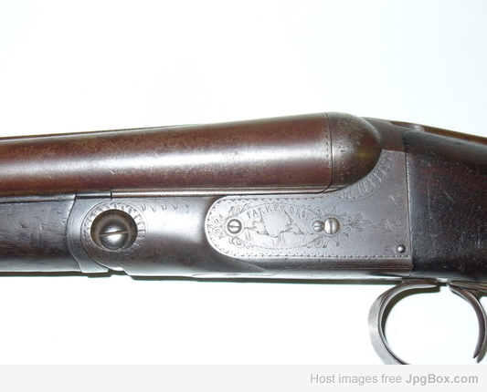

My friend's mother passed away recently and he stopped by yesterday for a little b-day get together and brought along his dad's guns for me to take a look at. His dad had died while we were still in college almost 30 years go. I remember her showing them to us back then but she was very protective of them and back in the cases they went.
One is an old Savage bolt action 4C, 22lr repeater. Good used condition in need of a light cleaning, but well preserved. The other is a Parker 12 gage in similar condition but I know nothing about vintage shotguns other than it's a classic. Joe was a bird hunter all his life, they weren't sure if he had bought the gun before or after his time in the Navy in WWII. It's in very good shape mechanically. Locks up tight and everything works like it should but is well worn like an old side by side should be.
Any info on what model/ grade it is would be greatly appreciated. I figured I'd start here before buying any more books.

Very nice Jason, blue looks good, some case color too!
I do love Parkers but I know squat about them. 6pt is the master of Parker's here on the forum. I'd wait to hear from him !

The minimal amount of engraving is less than any of my D grade Parkers, which includes my Damascus barreled 20 ga made in 1900 shown below or my Parker reproductions.
Parker did make a Trojan line and maybe other lesser decorated guns. My recommendation would to go post those pix on the PGCA (Parker Gun Collector Association) site and you will get all the information you want and maybe more. There are even folk there that worked for Parker distributors and REALLY know their stuff.
http://www.parkerguns.org/
Enjoy.

According to the Parker site it was made in 1902. V Grade with a number 2 frame. Barrels are 28". Looking in a really outdated Blue Book, the Trojan model wasn't made until the '30s. Best guess so far is that it is a VH model.

Nice Parker. I second the VH grade.
Take a close look at the head of the stock, particularly the right side where the head of the stock meets the action and tang. From the pictures it appears there is a gap between wood and metal and the wood is proud. This could indicate a crack in the head of the stock that needs attention before you shoot it. At the least have someone knowledgeable look at it.
If the lockup is still tight, it’s on face, and you get the stock tender to, you could get it afield with some low pressure loads.

You have a VH built on a 2 frame that was made in 1902 . From your pics I couldn’t see if it has ejectors or extractors . If it has ejectors it’s a VHE . Looks in pretty decent shape !

That gun has relatively good case coloring although light but you can still see it . Almost all the screws appear not messed with or buggered . The wood at the cheeks or head of the stock whichever you care to call it looks a little to proud but that might be an optical illusion. There’s nothing wrong with a VH it’s the lowest graded Parker VH then PH thrn GH then DH then CH next BH next AH then AAH then A-1 Special and finally the Invincable . While they made a Trogan that was a more utilitarian less costly to produce version and not what’s considered a graded version . I’ve got VH or VHE Guns in 12 , 16 , 20 and 28 . Probably my finest two Parker’s are the little VHE 20 and the new addition VH 28 .

Will either or both barrels float a dime ? Typically I would say a 28” would be M&F however I’ve found with a Parker most any choke combination is possible and the right barrel isn’t necissarily the more open barrel .

Now I’m not telling you to do this that or the other when it comes to shooting this gun . However if it were in my possession I would after I tapped the barrels to see if they rang true and had the butt stock looked at . But when time came to shoot I have no issue with shooting factory express loads of the situation warrants it . Now my 12 gauge handloads are low enough pressure wise where I don’t have any second thoughts about shooting them in damascus Guns . I just load the low pressure shells so I need not worry about putting the wrong ones in the damascus Guns . But if I only had fluid steel 12’s I’d load them a bit warmer .

No need to guess, on graded Parkers, as the grade was always marked in the frame's watertable - please note the tiny "v" stamped there, just above the frame SN.
