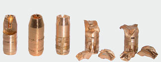

First, an explanation. I started off with the 235gr TSX cut to 185gr and posted the details and range report here http://marlinowners.com/board/viewtopic ... sc&start=0.
This post is making heavier bullets, from the Barnes 270 and 300gr TSX's.
So here it is.
OK, the 270 and 300gr bullets arrived, as mentioned. This afternoon I did a few to see how close I got in my weight guess. It turns out the 270gr TSX came out right at 220-223gr, and the 300gr TSX came out at 255gr, finished.
I guessed pretty close. I have lots of pics to show and will explain as I post them.
The image above is a side by side comparison, which I never did before. Thought you'd like to see how it started. On the left is the finished 220gr bullet, next to the 270gr it started as. Then the 255gr next to the 300gr that IT started as.
Next we have the 250gr Hornady bullet I made from the 270gr spire point, and wrote about in my article, on my website. The center bullet is the 225gr finished and the far right is the 255gr finished.
Here's a pic of the three above laying on their side. Note, the cannelure of the Hornady, lines up with the groove in the TSX's where the case is crimped. This gives you a look at how much bullet is down in the case. Please note the 225gr TSX is the same, in the case, length as the Hornady. This gives me ideas along the lines of Paco's loads and the 38-55 case, but for the purposes of these tests, I'll stick to 375 brass.
Here's a pic of the three side by side, along with another one laying down to you an idea of the hollow point. It's .330" deep and about .250" wide at the mouth.
and one last pic with the three laid out on a piece of paper, labeled. I may get a chance to go this weekend for a pig, I hope it works out. I will definately take pics and post results if I do. Also 375win may get out on April 15th for the same.
Let me tell ya folks, these were BIG bullets when I started. I'd like to see how they perform from the factory out of a 375 cal bolt gun into big game. That 300gr bullet from something like a 375 Taylor (338 Win Mag necked up to 375) would be devastating on even an Alaska Brown Bear. It's a LONG bullet too.

You have given hope to california levergun hunters! Thank you so much for all the time you put into this project! I bet those barns H.P.'s would do a number on game.
Awesome. I was really impressed with the examples you brought to the get together last weekend. Did I hear you right that you are going to send some to Barnes so they can check them out?
I cant wait to read your game report when you get back from your hunt. Where are you going?

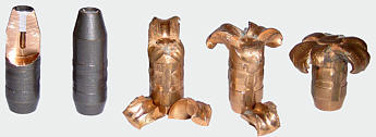

handirifle -
As you have discovered that in order for Barnes to make a reasonably heavy bullet out of pure copper, they have to make the bullet awfully long.
Here is an example of what I'm talking about. The bullet on the left as you're looking at the picture is a Speer 240gr (.429) Soft Point the bullet in the center is a Hornady 265gr (.430) Soft Point/Flat Point and the bullet on the right as you're looking at the picture is a Barnes 225gr (.429) Hollow Point.
I think you know that I have .444 Marlin rifles that I want a non-lead bullet for and so far the only one available is the .225gr Barnes bullet. It doesn't instill much confidence that the .225gr Barnes Copper bullet will perform like my lead based/lead bullets from .240gr through 290gr.
However, I've read some articles on Barnes Copper bullets and have talked to some guys who use them here in my area and the articles and the guys who shoot the Barnes Copper bullets said/say that the key to Barnes Copper bullets is their uniform expansion without weight loss due to bullet fragmentation. As an example let's say that I shoot a deer with a Hornady .444 (.430) 265gr bullet and after the bullet is recovered, the bullet weighs 212gr due to 20% weight loss because of fragmentation. Now lets say I shoot another deer with a Barnes Copper .444 (.429) 225gr bullet and the bullet expands/mushrooms with no weight loss due to fragmentation and the recovered bullet does indeed weigh 225gr. Guys, articles, and Barnes all say that the 225gr Barnes Copper bullet is more effective that the 265gr Hornady bullet because the Barnes bullet retained all it weight and transferred all it's energy to the animal shot. Not sure I buy this completely but I'm willing to give it a try.
Barnes and some of the guys say that the mushroomed petals of the Barnes Copper bullets are sharp and that they cause massive internal bleeding and damage which lead to immediate/quick kills. Will have to see.
Sorry for being a little long here and I hope you've gotten my drift and that I made sense.
Great work on your part and I'm following it closely.

just looking at the 30-30 Barnes bullets I bought, I would have to say that the petals look wicked.
I am looking for a bullet for the 35 Remington and their 140 grain pistol bullet doesn't inspire confidence in me, either. How would it penetrate bone? But for game like deer, they should be great.
I think we just need to re-think our assumptions, if a bullet expands like that and cuts tissue, who cares how heavy it is?

Modoc
I was talking with old savage this afternoon, and he was giving me an example of your theory. He shot a small Antelope on a frontal quartering shot, with a 6MM 100gr bullet.
The bullet was recovered in the hind quarters adn all that was left was a ball weighing about 30gr. That's a 70% loss of weight and energy.
Now considering the Barnes 85gr TSX, if it retained even 90% of it's weight, that' still over 76gr left. A 10% loss compared to a 70% loss is pretty good.

OK more data for everyone. I copied this from the Marlin owners forum, cause I want to give credit where due. a poster named "PB" over there made a suggestion, and I followed up on it. here's the result.
I hope you like it.
Handi
PB wrote:
Back to the Barnes bullets for a second. I don't think I would be too happy with the BC #'s you are getting. Is it possible to cut the rear off the Barnes bullet to bring down the length and then the tip off the nose. Pb
PB I think you're a genius! ;D
Well got to thinking tonight about what you'd said (above quote) and during a movie the wife and I were watching, it hit me, so when I got home, I put one in the cutting template and cut the base down a bit, turned it around and cut off the tip. Smaller portion off the tip.
Well a couple things became VERY obvious. First, there's no more doing the ogive on the lathe, so repeatability is WAAAY less of a problem.
Second, the nose is obviously longer and sleeker which has to bring the BC up (it does, more on that later).
Third, it's FASTER to do it this way, DUH! I'm glad I posted this project on here, cause sometimes we can't see the forrest for the trees, but you did.
OK I have lots of pics to show you guys and will try to explain as I go. I'm REALLY excited about the "new" design. I think we have a final design here that will do it all.
First, let me regress (and tease you guys a bit) earlier I mentioned my cutting template. This is the one I made from 3/4" aluminum bar stock. here's a pic of the one for the 270gr bullet (laying down) and the one for the 235gr bullet. On both, they are drilled to .378 and both have a 1/8" hole through the rear, to allow me to push them out after cutting. Mostly they fall out, but not always.
OK, next is the latest generation, cut like PB recommended, next to the version, I THOUGHT would be the easiest of all to make. by the way, the one on the left weighs 215gr and the new one (right) weighs 203.
Next, I have the previous two, next to the Sierra 200gr SP.
Next is what the new gen bullet, loaded, along side the previous generation. At first look, you'll notice the newer bullet, just plain looks better. In addition, due to the longer nose, it's seated down to the first pressure groove.
I haven't tried this in function, but will, and have no doubts about it working. If, by chance it DOESN'T :o :(, I will post.
One last pic, since I mentioned my 223 case BUB bullet (butt ugly bullet) filled with no lead solder, here's a pic of it too. Keep in mind, this is a first prototype, with no real swaging done, so ogive is pretty much non existant.
Oh, yes, the BC of the new design, is .146. Not terrific, but better than the old one. Before you ask, the nose is better left empty in this design (I asked Barnes) to allow body fluids to fill the cavity, and force open the nose petals, which by the way, are left way more intact than the other designs.
Hope y'all enjoy.

Well, it not only functions, but does it smoother. Oh, yes, also, I'd suspected this looked like a similar profile to the Speer 170gr flat point for the 30-30, and it's almost a perfect match. The Barnes bullet is about 1/16" longer, and larger dia, of course.
