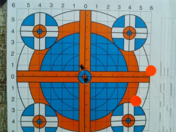

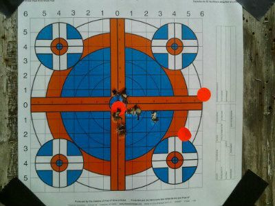

Anyway took my 45 Rossi out to our range yesterday and sighted it in with Freedom Ammo 250gr RNFP before I started shooting my handloads. I had installed new sites from Steve's Gunz and they absolutely rock!! I set my rear sight in the middle and fired two shots, 6 to 8" right of center. I drifted the front sight just a little bit and fired two more. Bullseyes, so I covered my holes with orange stickers and backed out to 100yrds. I will let the pictures show the rest of the story, needless to say I am very happy with a rifle that I hadnt previously considered a hunting rifle.
