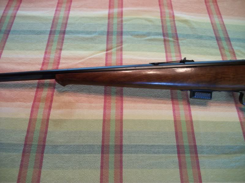

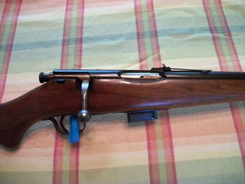

Ok , things are looking up for the sporter . Took the new ammo out and ran half a dozen rounds through it this morning at 50 yards. The pattern ( my poor shooting :roll: ) was tighter at 50 than my first try at 25 8) It shot better than my 22 at the same target . So I needless to say , I need to really get to the range a lot more often :lol:
Any who , I guess I've decided I won't use this for a tomato stake in the garden after all :D :D so here are a couple more pics of the rifle.
Phil
Posts: 4909
Re: It's not a lever 32-20
Post by .45colt »
Be still My Heart.I have seen a few of those usually beat pretty good. that one is very nice.If You every want to sell it drop Me a P.M. it would look great with My Marlin.
