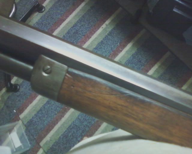

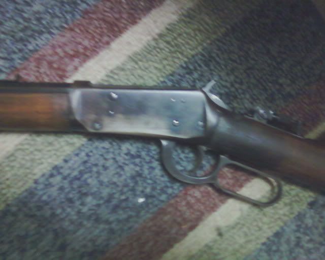

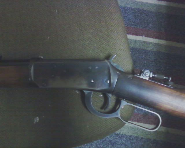

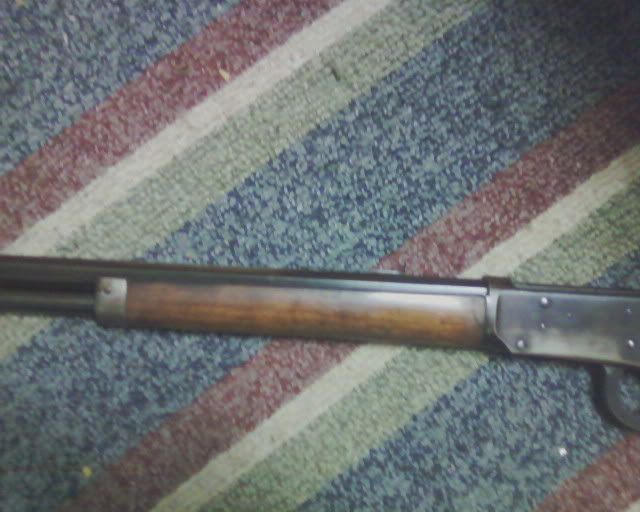

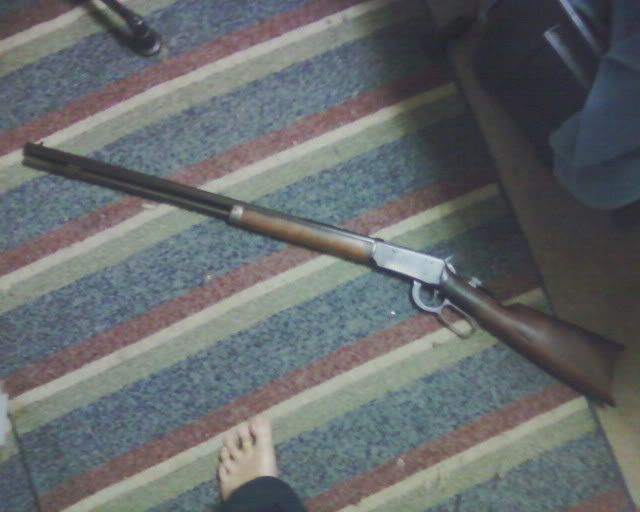

Well, its been a long time coming. I have been roughly working on this rifle for almost a year now. Bought a pretty rough 20" carbine 30-30. Then I bought a 26'' octagon barrel and mag tube.
When I got the original rifle all the bluing was gone but I still had lots of metal prep to do. I ordered a stock set off of eBay (Mistake). It was very rough fitting and my lack of woodworking skill really did a number on the stock. I sent it to a friend here and he said it could be saved but would be ugly.....Then we found out the forearm was not the right one. So......a complete waste of money on the wood.
For the receiver I was going to send it off for Color Case Hardening but then decided I would go with a worn look.
The rifle sat dormant for months as I did other things but recently I decided to start working on it some more in my free time....what little I have. I was ordering me some parts from Numrich and seen they had a buttstock like I wanted. I jumped on it because I was having a hard time finding curved buttplate stocks for a post 64 94.
Its still a ways from being finished. Need the barrel installed and headspaced and then I will order the forearm when I measure and see just what length I need.
Anyways....here are a few pics. Still have some metal work left to do to get the gun to have the look I want but maybe you can get the idea. Also, I will be working with the stock once I get the forearm to get it to look like the gun has been used.
Here is when I first got the gun;
After a little work;
and after I decided to actually do some real work on it......this is tonight but with plenty left;
Hope you guys dont mind the progress pics. Maybe soon I will have some finished pics and then a range report.

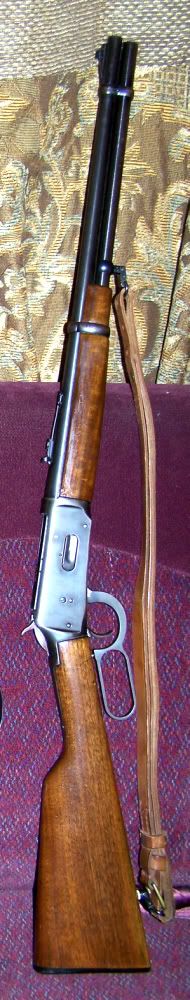

Very nice. You have the right idea. That rifle is going to be nice. I tried the "used & weathered" look on my pawnshop special, and I really like it:
Before, with peeling wood & pitted metal:
After, with judicious sanding of the metal, wood stripping with carburetor cleaner, and metal finishing with Super Blue, and Tru-Oil for the wood:
I even put long wood on the front, and an old leather sling on it:
Shawn

I got my barrel from Numrich. Its a 26" oct barrel in 38-55. Color case hardening is done by packing the parts in bone/charcoal and bringing it to a certain temp for certain time. I wanted to do it that way but not many people will do a post 64 receiver. I did find someone who would be just decided to go a different route for my first build.

I finished the receiver with with a cold bluing process but rubbing it back off in places and heating it up etc.......then added some plum brown to the parts also. Then gun oil.
I have not began on the wood yet because I want to get my forearm first so it can all be done at the same time.

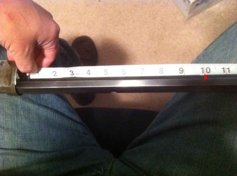

How much would you need to turn the barrel to make it look like it is on correctly?

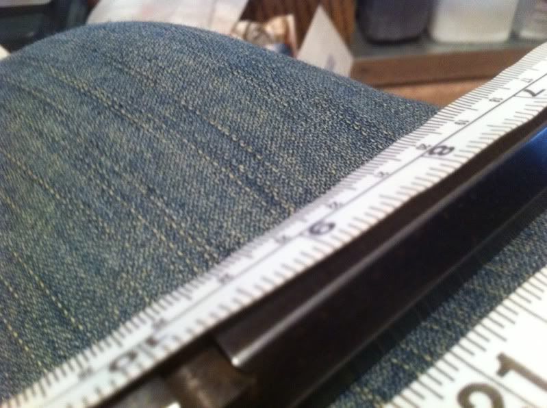

Well I just hand tightened it. I am not sure how much further it would actually turn with a wrench on it and also be properly headspaced.

How much farther do you need to screw on the barrel to get the extractor groove at twelve o'clock. Is it it at 1 oclock now? 94 Winchester's are usually headspaced correctly when the end of the barrel is flush with the inside of the receiver. Just look at another Winchester 94 and you will see what I mean. I did this same project five years ago and will not be dissapointed on how that numrich shoots.

you can get that barrel on yourself,
just put one end in a vise and spin on the other.
each time it comes up snug, back off half a turn and
then snug it up again. each time it should turn a
little farther. when the extractor cuts line up stop.
most win. '94 barrels will headspace just fine when
the slots line up.
good luck and nice project so far. :wink:

I have it pretty much where I want it now. Been working with it some....and it DID take some working with.

Ok, well the barrel is on. Im now looking for a forend that I can use on the gun.
I do have a question though if I may.
Winchester made several different length forends. When im measuring to figure out which length I need, Where exactly am I measuring to and from?
I am getting roughtly 10 1/4 inches from where the stock will sit against the receiver to the end of the dovetail on the barrel.
10 inches is still inside the dovetail.
I guess if I was to find a 10" forend that it would work. Am I correct in this thinking?
Should search for one that is a little longer than 10"
Nothing is local so im hoping to get it right the first time to keep cost down.
These things are hard enough to find as it is.

I used the pre 64 fore end on mine , it's slimer than the post 64. Mine has the Numrich barrel with cut at 10 inches. The forend cap I got at Numrich but they didnt have the piece that fits in the dovetail cut that the forend cap screws to, i got one at a gunshow. I 've read people get them from Uberti parts, which is for the replica 1873's. the forewood I got from midway, fitting is required.
This is mine.
gunner69
Posts: 78
Joined: Sun Aug 08, 2010 10:11 am
Re: 38-55 Project
Post by gunner69 »
That looks nice, I see you used the "shotgun" style butt plate. That's a good idea as it "evens up" the recoil.
Posts: 21540
Re: 38-55 Project
Rube,
I'm finally back at home, and just measured my .30-30 with the Numrich barrel. My forend measures 10-¼" of exposed wood.
Rube Burrows
Posts: 2225
Location: Louisiana
Re: 38-55 Project
Post by Rube Burrows »
Thanks guys.
Griff, do you mean from the end of the cap to the start of the receiver?
Both of the rifles above are very nice looking. I can see the finish line with this one and just hope that I can find the right forend for it soon.
Posts: 21540
Re: 38-55 Project
Rube Burrows wrote:Thanks guys.
Yes.
