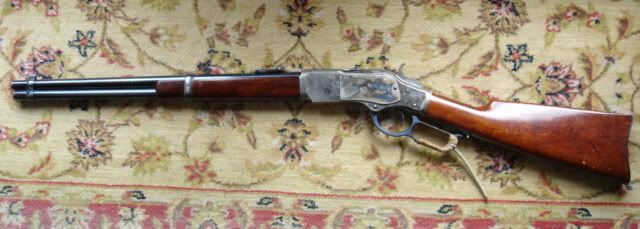

Terry is correct. The Uberti 73 in 357 is proofed for the the 357 and is safe to use with any 357 factory load. Reload it within SAAMI specs and you will be a happy camper. The 1873 SRC is my favorite levergun.
This is my Cimmie SRC.
