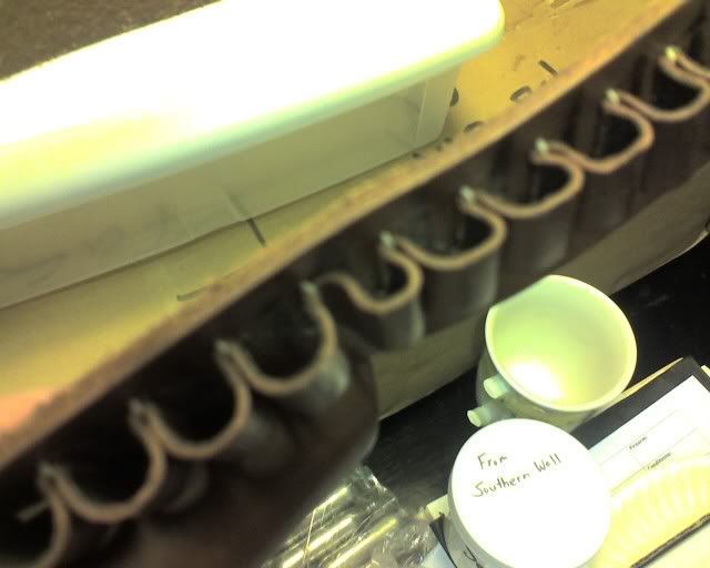

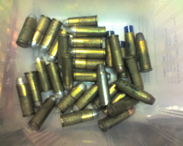

Also came across two gun belts - where I had left cartridges in the belt loops! :shock: You all know what happened next. The cartridges themselves are a nice sticky green where the brass sat in contact with the leather for too long, and the leather is stained. Here are some pictures - sorry for the poor quality (camera in my cell phone).
Question: What is the best (and safest) way to clean the cartridges that won't ruin them?
Question # 2: What is the best way to clean the leather that again won't make things worse?
000 or 0000 Steel wool.
Saddle Soap, and cool water. Yuo might need to use a SOFT toothbrush to break the green away. Then retreat the leather. I'm no expert on leather, but from making the same mistake...
I like the Goergia Boot Conditioner for my holsters and such. it will darken brown leather, but works really good. Neatsfoot oil is ok, but it might soften the cartridge loops too much?
Glad you found it!

If you try a soapy rag on the cartridges first, you might not need as much elbow grease on the steel wool.

"cutter" gave some good advice. I recently cleaned an old, leather, military sling with the brass fittings with Hoppes #9 and a toothbrush. A brass cleaner may help with the finishing touches on the brass. I keep Flitz wipes on hand for small brass cleaning jobs.

When I had a leather / verdigris / mold problem I was told to wash the leather with white vinegar which got rid of the mold. Then to use Lexal Leather cleaner and after that Lexal conditioner.
That saved most of my leather.
As for the cartridges I'd just wipe them down, shoot 'em then toss them into the tumbler.
Don McDowell
Post by Don McDowell »
That green crud is a reaction of the brass/caselube/tanning chemical. It'll happen any time you leave cartridges in the belt for an extended period of time.
Best way to fix the problem? Shootem up don't let loaded cartridges sit around long, keep empting and reloading. :D

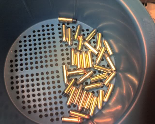

Ysable Kid, I had some 475 Linebaugh's that got cruddy so I threw them in the tumbler, cleaned up real nice. I don't know if it is true or not but was told that the factory's tumble after loading their ammo. Oh, when I say tumble I mean a vibratory type.

Saddle Soap for the leather then treat with mink oil. Every one else covered the brass.

Maybe some saddle soap, but I've seen Lexol cleaner followed by the conditioner really clean up abused leather very, very nice!

This is an age old problem. Here's my solution:
Clean the cartidges with any household cleaner, like 409. Don't need to shoot them up.
A weak vinegar soution with water used to scrubb away the green icky stuff. Use a tooth & small bottle brush. That will clean up the green stuff. Coat your loops with a good saddle soap & conditioner, that will help the leather from reacting to the sovents we use in cartridge prep. They won't get loose either.
If your loops are loose, soak the belt in water for a day & hang to dry. Then condition. Loops will loosen up over time & use, just use the water treatment to tighten the leather up. Oil the leather sparingly, you don't want it to be soft, just treated to preserve.
If your sixgun becomes loose, smear grease all over it, shove it in the scabbard and drop the whole works in a bucket of water over night. Pull the sixgun the next day & thoroughly clean & oil (complete disasembly is a must). Hang the scabbard up to dry. Should be only another day for the scabbard to dry. Do a complete treatment on the leather using Neatsfoot oil. Not too much, just enough to treat & preserve the leather. It should turn out real stiff & last a good while. This is an old way of fitting a holster to the gun.
If you want the shells to stay pretty and the leather to stay clean, use a rattle can of clear laquer (sic) on the shells. Let dry. They won't corrode after that.
My .45 BH is my battle gun in a gunbelt that has 40 loops. When I used this prep it has stayed ready & clean. The shells stay clean too!

Took OI's advice and plopped these into the tumbler, after rubbing off the bulk of the green slime with an old rag.
It worked like a charm! :D (this cruddy picture doesn't do the cartridges justice)
Now I just need to clean the leather! :shock:

I learned from a leather worker/saddle maker that Neatsfoot Oil will eat the stitching of your leather goods.
I don't know how true this is, I used it on my baseball gloves for 45 years (4 gloves)--some of the stitching could be better. But the boots I used it on were always blowing out the stitching.
He recommended Rudy's Tack and Saddle Conditioner and Finish.
Travis Morgan
Posts: 1581
Post by Travis Morgan »
Neatsfoot oil and Loxol both suck. They slowly rot stitching and degrade leather.
As for cleaning the bullet loops, use a nylon bore brush or a neck brush.
