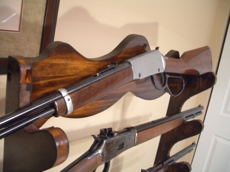

Ben: I haven't had that problem with my Henry's, so yours might be the way the rifle's carried.
FWIW, however, more than a few Henry owners with worn or scratched receiver covers, and/or bottom metal, have stripped the paint from the parts, polished them - then either clear-coated the silver finish:
Or applied some cold blue splotches to mime a CCH finish (also clear-coated for protection):

I like the "case" finish you applied to that receiver.
Can you tell us how you did it? I have a few rifles that could use that look.
Thanks!

That particular rifle isn't mine, Roy - but according to it's owner:rbertalotto wrote:Pete44
Thanks!
Strip (don't sand) the black paint from the receiver cover & file/whatever any gouges, etc before polishing to a shiney silver color.
Apply cold bluing solution with a cotton ball, via daubing (not wiping) the solution in various places as puddles, unevenly, until you get a look you like.
Wiping ILO daubing will impart straight(er) lines of blue on the metal - somewhat streaky, but some like that look, too.
If you don't succeed the first time, re-polish the cold blue off (after it dries) back to a silver color & try another method of twisting/daubing.
When you get the finished look you like, the cold bluing should be protected with a spray-on clearcoat, unless you want it to fade over time (short time) like real case colors.
I suppose, if you like the somewhat faded CCH look, you could delay applying the clearcoat until after the CCH fades to a degree you like.
