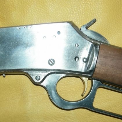

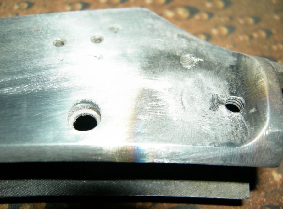

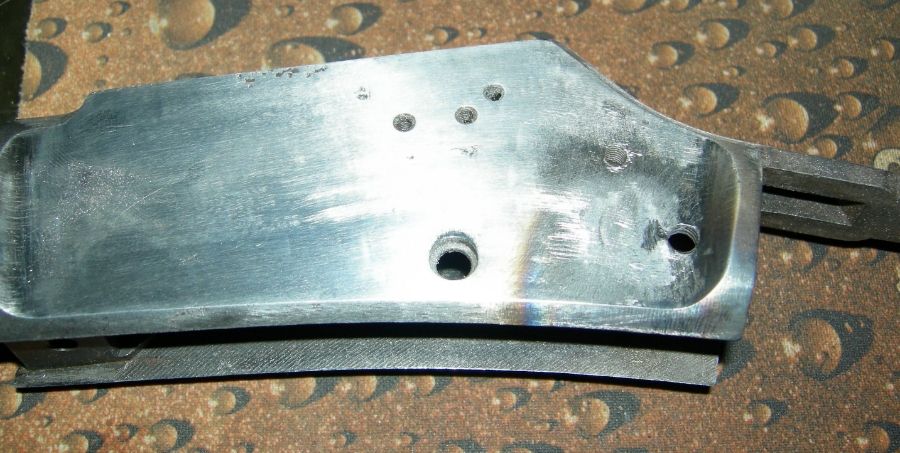

Having a pro do it can be cost effective... I had a local guy do some welding for me making brackets for my truck's rear fenders... super job, not cost prohibitive and he did what I could have with my 40 year old stick welder... but so much better looking.
I asked him if he could fill a hole in 4140 gun steel... his only question was... "how big's the hole?"
Before:
After sanding:
Close-up:
Cost? $0.00. Turns out the guy is also gun crank! Loved that I was makin' something from what some would consider a piece of junk!
Still have to finish sanding and polishing, then when it gets CCH'd, I don't think any of that will be visible... well, at least from a distance!!!
