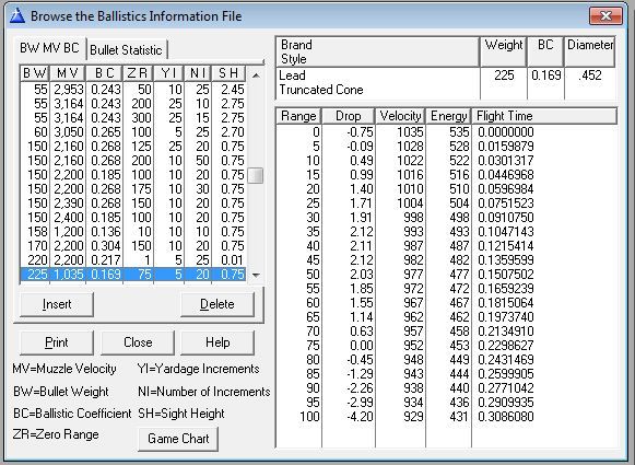

Posts: 21492
Re: Loading 45colt Hornaday 225 FTX's in my 1892 Trapper
That 1892 will handle just about ANY load you'll find in a reloading manual. Including those listed under Ruger or Thompson-Center. Myself, I'd load up a dummy round in regular brass and the FTC to actually try it in the '92 action before I shelved the possibility that it might feed & cycle.
The performance listed in that chart doesn't seem any better than my 225 truncated cone cast loads with 12.9 grains of Blue Dot.
Mind ya, I don't actually KNOW that I'm getting 1,036fps outta my 20" Rossi 1892, as the day of my tests, the tripod for the chronograph broke... so it's just a "best guess" situation. But... if a 250 grain lead gets 1,028 from a 5.5, I'm probably a little on the conservative side. And that jacketed FTX bullet oughta go faster. Again, a guess-timate!
