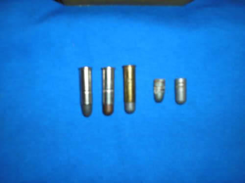

I can totally understand why these things can take on a life of their own. Take a couple of these bullets:
cast in a hard alloy, then add a soft primer and you might get a detonation with the left one. Or with one of these:
or maybe a:
Or look at these:
compared to these:
Both are called a "round nose", but one is certainly "more round" than the other.
Cast them hard and if using a Federal or Winchester primer, I would feel much more comfortable with the last one than any of the 3 above it.
I have loaded, literally, many, many thousands of these 158 grain round nose bullets
for use in CAS by my wife and son outta their Colt SAAs and Rossi 92 leverguns and never, even using almost exclusively, Winchester SP primers had a dented primer caused by a bullet nose, let alone a detonation. And I cast them using a fairly hard alloy, 6:1 (WW:Linotype).
It's not the label "round" that bothers me, it's the actual roundness of the bullet that I take note of.
And, as you can see in my first post, those .30-30 bullets don't actually touch the primer of the bullet in front of it when laid end-to-end.

I have really enjoyed reading all of these responses, and I need to think of something else to ask. You folks are great, and I'm certain I am going to have a great time on this forum. Thanks!!
Mike, I hadn't thought about how the cartridges lay in the magazine, until you and a couple others mentioned it. I guess I probably had it in my head that these rounds would touch each other horizontally like they would if stacked vertically, which of course, is nuts.
