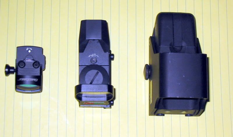

Re: What scope / optics for Rossi M92 .357/.38
This thread has some photos of the various 'holographic' sights, and is why I favor the Burris Fastfire-II over all the others. Even the smallest 'red-dot' sight I've used (the Millet 1" tube one) is huge in comparison.
http://www.levergunscommunity.com/viewt ... =1&t=28788
Here's a picture of the holosights I looked at...
Many people love the Bushnell/EoTech holosights and they are 'milspec' and durable, but compared to the Burris Fastfire-II, they are huge.
