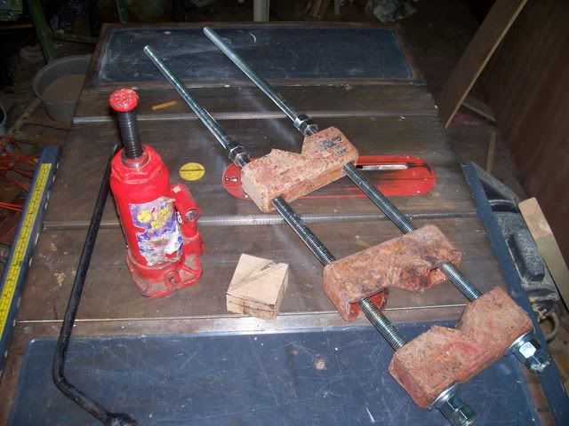

I have taken 'em off and put 'em back on. I made similar action wrench and made a barrel vice that used a 2 ton bottle jack, 2 7/8" all threads and blocks of oak inletted to hold the barrel.

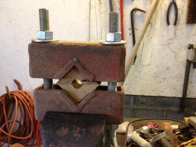

I was poking around in my shop today and came across my "new and improved" barrel vice. It had been long enough since I made it, I had forgotten it.
Here's the old one that used the jack.
Here's the new and improved.
The jaws are tractor tool bar clamps and the blocks are oak.
Edit: I just noticed the receiver wrench is hanging on the wall behind it. I made the wrench out of bar stock and wrapped them in sheet aluminum to avoid marring the receiver. It bolts together.
