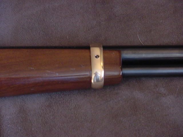

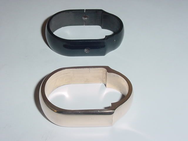

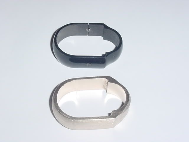

Let's see if I can figure this picture thing out... (well that worked so I'll put them all in)
Step 1 - bored 2 holes and then connected them together with a straight cut. Test fit on the gun and was OK so off to the belt sander
Step 2 - Roughed the OD on the belt sander
Step 3 -Scribed the OD and got it close on the belt sander
Step 4- Started to add some radius on the OD - hand file
Step 5 - Added the reverse dimple on the top - used a small hand held drum sander
Step 6 - A little closer...now using 180 grit sand paper and some fine to finish
Step 7- Just a few moments on the polishing wheel
Step 8-Installed on the gun - skipped the drilling of the pin hole - left that for last so they wouldn't interfere with the sanding and polishing
Step 9-Close up - actually it looks better in person - I'm not that great of a picture taker
So there is my weekend project - it came out pretty good - way too much time in it since you can get these for 20 bucks, but I'm glad I did it methinks it adds a little to the rifle.
