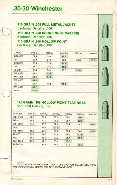

Re: BEST 110gr jacketed 30-30 for 336??
John,
The 110 Sierra H.P. has been made for a long time. It is not listed in the Sierra manual for the 30-30 since its typical use would be in a bolt action .308 or .30-06. Its profile closely resembled the original 30-30 110 factory cartridge so I decided to give them a try. They shoot very well from my Winchester '94 Centennial and 336A Marlin rifles.
w30wcf
w30wcf
Hmmm...no load data in their own manual.
So I quickly check with LoadData.com, which shows actual data from manuals and magazine articles in addition to unknown/unverified testers. I found some listings for this round with the bolt-action and the notes that it is inaccurate, and stopped there.
Er...and Sierra's are expensive. Nope - think I'll start elsewhere for my levergun critter gitters. Thanks anyway!

John,
I shoot quite a bit of the Sierra 110 HP with 2 Marlin 336 30-30s. They are accurate in both (in this case "accurate" means holding 2" in 100 yards consistenly). I did a lot of testing with several different light bullets a couple of years ago and settled in the Sierra HP because it was accurate and explosive. If you are looking for a small game bullet, you might not like the way this Varmint Bullet destroys critters. Its exactly what I was looking for - blowing up coyotes - I don't eat coyotes.
I found that my rifles liked most of the 110 gn bullets. The VMax, Hornday RN, Hornady SP all did very well. The Remington RN was another story. This bullet is sized .307 and is not accurate at all in my micro groove Marlins.
If you want a small game bullet, I would recommend the Hornady or Sierra RN or the Hornady SP. The SP has to be loaded 2 at a time but is just as accurate as the HP and has a much better BC. If you have to be able to load up the tube, the Sierra RN is also accurate in my rifles. Also, the Sierra RN is available at Powder Valley and Natchez for 16 cents a copy.
I am using Reloader 7. Max in my Marlins is about 34 gr but I found the best accuracy at 32.5 gr.
I know one guy how uses BL(C)-2 and H335. Hornady does have data for the 110 RN / 30-30 in their book. I haven't seen any diff between the Hornady RN and Sierra RN.
Bob A
OOPs,
I just looked at your first post again. You wrote Varmint and I guess I read Small Game.
I would definately recommend the Sierra 110 HP.
Bob A
Bob A
