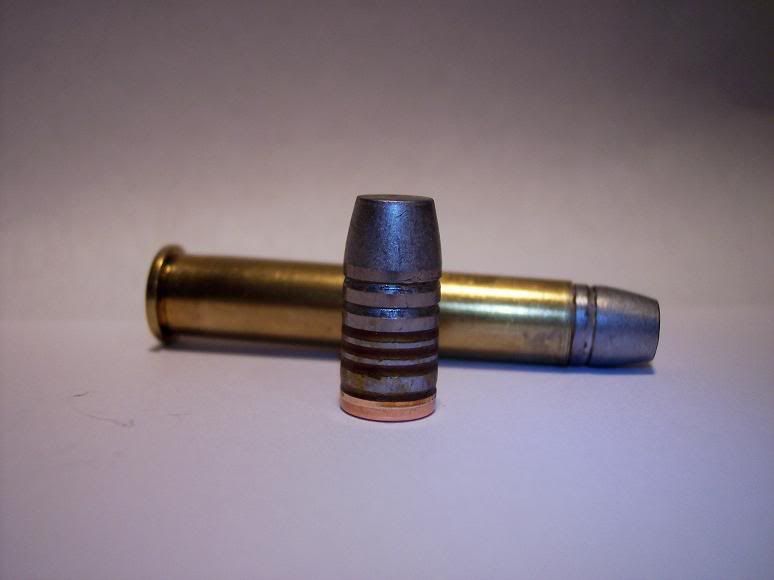

I went about my business, shooting the Marlins in 356 Win, 375, and 218 Bee. All the loads were topped with my cast bullets, all from Ranch Dog molds. After firing this 1.9" 100 yard group and another just like it from the 375, I settled on this load of a healthy charge of RL7 and bullets cast from a Lyman #2 duplicate, water dropped. I was pretty excited about this load, a 230 gr. flat nose thumper moving out at 2200 fps should put the whammy on anything I'm likely to encounter.

That is one fine looking group! And I must say that you did steely man well on that .50 BMG shot. I'd have flinched for sure.
A guestion: Why are you seating the bullet to the second ring? Is that for better accuracy or because you need the case volume? Just curious (I don't load yet but I'm gettin' my mind set on it).

Oly, to answer your question, yes and yes. Ranch Dog designed this mold to fill the throat in Marlin chambers when seated to the bottom crimp groove. The other crimp groove is to accomodate other various chambers. The load I settled on is slightly compressed when seated to the bottom groove.
