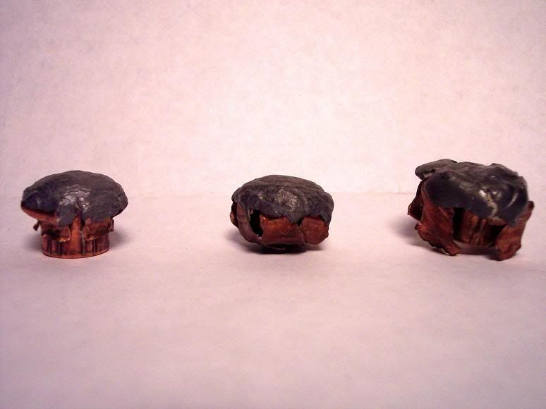

These are all three Hornady XTP bullets fired from 20" leverguns into soaked phone books from about 20 yards. All were loaded near max with velocities between 1650 and 1800 fps.
Left to right, 240 gr. 44 cal., 250 gr. 45 cal., 300 gr. 45 cal. XTP MAG
Retained weight for the 44 cal 240/223gr., 45 cal 250/214 gr., 45 cal 300/275.
Did I mention I am quite fond of the XTP bullet in a variety of calibers? 8)

Ricky, I find it curious that your bullets did not expand after being shot through wood, and that my XTP mags did not expand at 1200 fps in wall board despite Hornady saying they should at that velocity. I wonder if it is a classic case of a hard material jamming/filling in the hollow point and not expanding????? The only thing that doesn't make sense to me is why would the bullets I've tested still work so well when fired into dirt then???
-Tutt

Tutt, of the 6 bullets that I tested, all the same way, the 240mag and 300 mag are the only ones that failed to expand. Now I only did a small sampling so it's not very conclusive. You could be right about the hollow point clogging up but I did not find any wood in the hollow points of the bullets when recovered.
Ricky

It is my belief that you simply can not test the ability of a bullet to expand by shooting into a hard material such as wood, drywall or dirt. The bullets are designed to expand in flesh which is comprised of something like 70% fluid.
The bullets that were fired through boards in front of water jugs may have lost too much velocity going through the wood and weren't in their velocity "window" when hitting the water? Or the HPs were filled with wood debris.

Good morning. This might help with the Rossi question.

The way i see it as long as hollow points flatten, they act like wad cutters after they find their mark and could potentially work better than hard cast. JMHO
