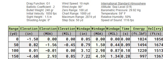

Do you guys bag deer inside 150 yard w authority or is the drop too much on a 240 in 44 cal.

My thoughts go back to Muzzleloader rifles.....and sabotted bullets. Think a 240gr XTP 44 or 250gr ish 45 is the norm.....and they kick
So "kick the living snot out of me" sounds bout right!

Yes muzzle loaders use 240s-300grain saboted but they also use 100-150grs of black powder/substitute. That's where the recoil comes in.
My Ruger 44 carbine is a gentle push but it is a gas operated and some recoil energy is used up. My Henry 41 mag is a little more obnoxious but no where near what my muzzle loader with 2 50gr 777 pellets and a 300gr .44 bullet is!
