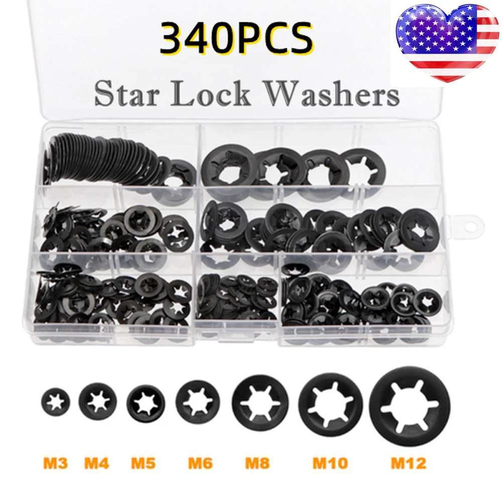

That's probably the 5th or 6th switch I've replaced... and at least the 2nd time I replaced the harness as the connection from that switch to harness is atrocious. Still have to find a lock thingie that keeps the cable on the temp control slide. Apparently you have to buy an assortment... to get one!

ace hardware, lowes, home depot carry them star washersGriff wrote: ↑Sat Sep 20, 2025 9:47 pm That's probably the 5th or 6th switch I've replaced... and at least the 2nd time I replaced the harness as the connection from that switch to harness is atrocious. Still have to find a lock thingie that keeps the cable on the temp control slide. Apparently you have to buy an assortment... to get one!![]()
