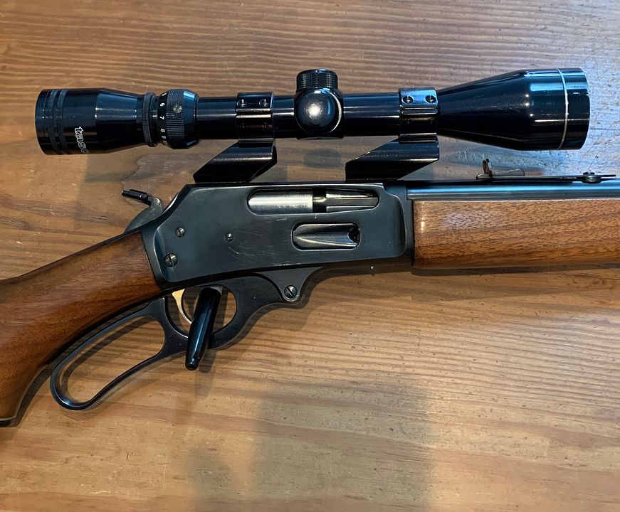

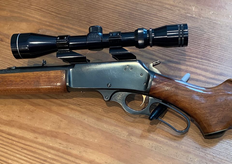

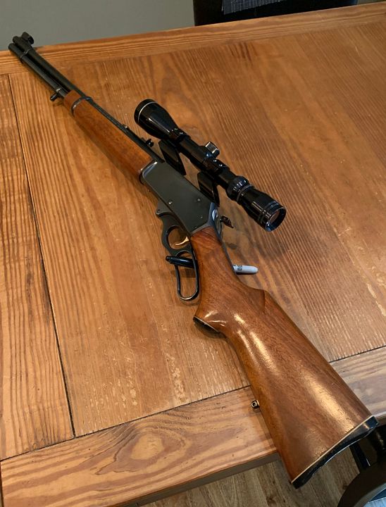

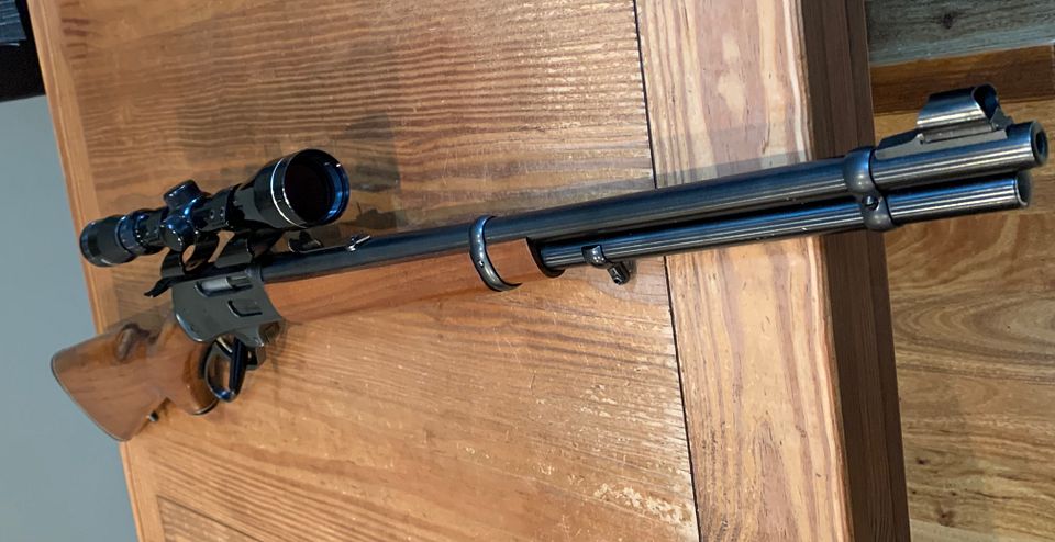

Just found this Marlin 336, 30-30 (mfg 1978) that I have been looking for for this project. Going to send it to JES in Oregon to have it rebored to 38-55.
The only thing is, it is a really nice, period correct deer rifle showing hardly any use at all. The Tasco 3-12x40 scope along with the “see through” mounts, front sling mount, and stocks (I think they are birch wood) are all going in a separate box out of respect to this great rifle. When I get it back from JES, I will install a set of Boyd stocks and Skinner sights to complete this project.
The lever action system is the smoothest of all my Marlins. The trigger has a nice crisp let off. All in all, the gun is almost too nice to be a project rifle but I got it for a beater gun price.
Will post more photos when it is complete.
Any comments will be appreciated.

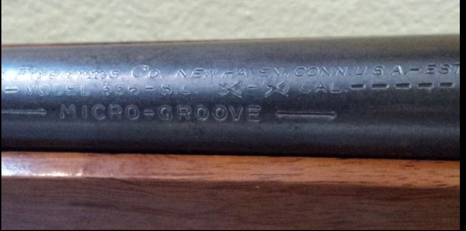

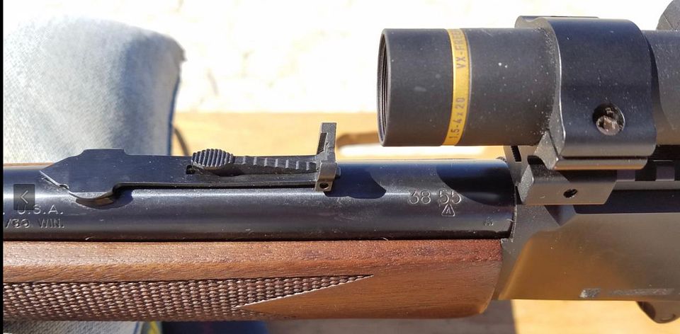

I think JES told me he just stamps dashes through the “30-30” roll marks on the barrel and then stamps 38-55 on top of the barrel near the receiver. My rifle is all boxed up and will be heading his way Monday. I found some photos on the web that show this.
I sort of like the markings that show what the donner rifle was.

Yes, he x's out the old caliber and stamps a new one. If one was to try to remove the caliber designation on a 336 it's sort of located inside the rollstamp and might result in removing other parts of the stamp also. I'd rather not have it removed, and leave it for me to handle. No reason to reblue the whole barrel just because you remove the cartridge stamp. I simply remove the stamp carefully and rust blue that tiny area.
