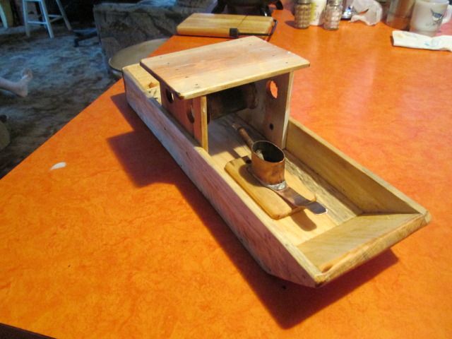

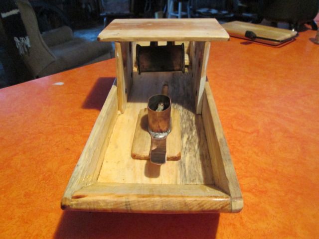

Decided to build a wood boat for the solid boiler engine. :)

Re: The wondrous pop pop boat
Played to the end for me, I think Pitchy.
I really like the wood boat. In Alaska we'd call that a power scow. They are common in the fishing industry. Or were, they're not getting replaced. If you deck it over to the sheerline and put the wheelhouse on top of that you'll have the flavor.
In New Jersey and along the eastern seaboard that form might be called a garvey. Before engines they were sailing scows tho.
Music to my ears. Thanks for the dream boats.
Thanks Grizz, can ya find me a picture of the boat your talking about.
I`m not sure how this engine in this boat will work or how fast it will go.
I think the boiler is to big but i`m just learning about these things myself.
this is a pretty good representation. they were mainly used as packers but I've seen them rigged as long liners and pot fishermen.
http://www.google.com/search?q=power+sc ... 68&bih=871
your wood one has very good proportions to my eye. I'm sure it could be scaled up to almost any size and perform well.
I fished around this one. It is set up for tendering fish. I've sold to her or to others just like her. You can see a fishing boat on the starboard side unloading or cleaning up after unloading more likely.

Pitch, I love your scow. Made out of pine and some oak?
Bill in Oregon wrote:Pitch, I love your scow. Made out of pine and some oak?
Pine and popular. :)

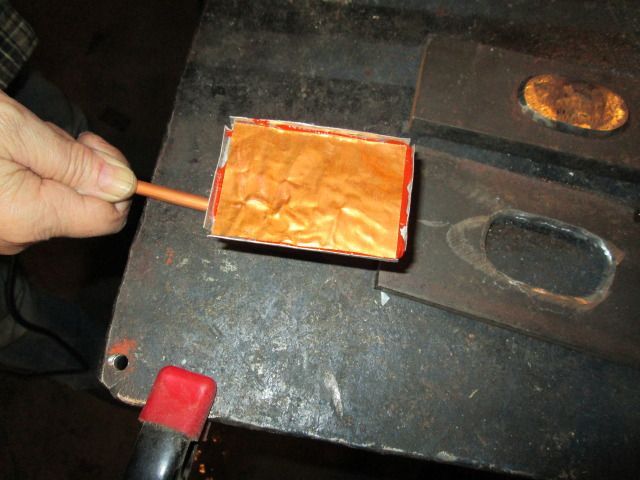

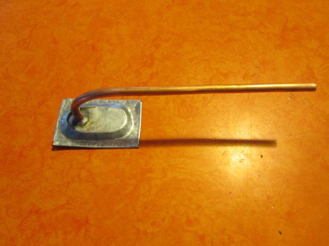

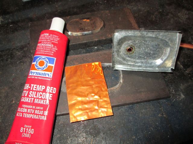

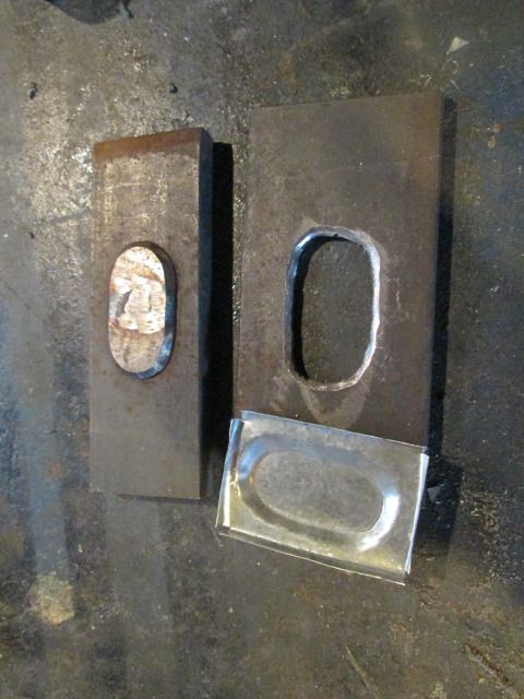

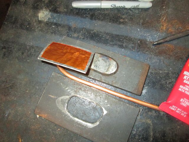

Fellers, i made a jig for making a small diaphram engine today and built an engine.
I`m waiting for the high temp silicone to set up then will give it a test run.
If it runs i will post a tutorial of the build.
Ok here we go.
The dimensions after the edges are folded over.
Width- 2 in.
Length-2 3/4
Tubing is 1/4 OD copper and 8 inch long.
Solder is plumber acid core.
The jig is made by cutting a hole in the bottom part as big as you want your engine to be, the dished part.
The other top plate had a piece of metal about 1/8 th in. thick tapered on the sides that fits flush in the hole in lower plate.
Lay a piece of light tim on the jig and center the top and hammer or press them together and it will form a dish in the tin.
Then slit the corners and bend about 1/8 th in of the edges up.
Then drill a hole or two depending how many tubes ya want in the end and solder the tube in as shown.
Put a bead of high temp silicone around the inside edge of the plate as shown and lay a piece of copper or pop can tin in and bend the edges over and squeeze them down with a pliers.
Let the silicone dry as i didn`t because i wanted to get this video done for this thread and it sprung a small leak.
Prime the engine, be sure the boiler is full and water is coming out the tube. Hold your finger over the end of the tube and put in the water.
Put a candle under the boiler and test run.
If ya have any questions ask away and i`ll try and answer the best i can.
Tube size and the number of tubes is up to you, this size engine normally would have two tubes half as big as the one i put on it, seems to work fine. :)
Video

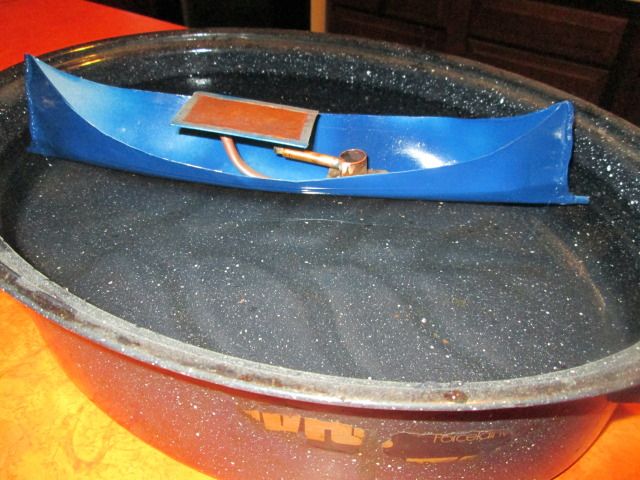

Made a canoe yesterday that is going to be fast. :)
It has only one tube.
I also made a three tube solid boiler that runs nice and will post it later.
video.

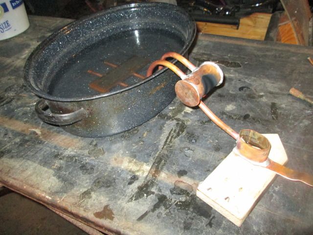

Pitchy-- you must have a lot of will- power I would have had to fill the bathtub at least once by now. :)
--J
J35nut wrote:Pitchy-- you must have a lot of will- power I would have had to fill the bathtub at least once by now. :)
--J
If we had a bath tub i would :shock: only a shower, that`s like a beached boat in a rain storm. :lol:

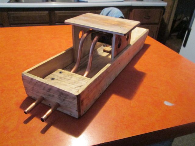

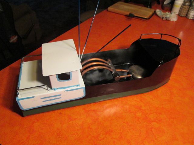

Well Grizz what ya think. :)
Three tube engine.
Man O man Pitchy
I think you did great!!!! You definitely have an eye for proportion. That just looks so cool!!
Can't wait to see it running the pond with the fleet. By the time the thaw happens you'll need a bigger pond!
That is really outstanding.
Thanks pard. :)

So does the third tube make it go faster or slower?
FWiedner wrote:So does the third tube make it go faster or slower?
Don`t know about faster but hopefully it will help give it enough power to move that tub. :)

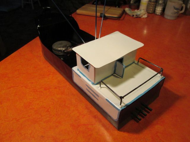

Added a white stripe on the front and name.
