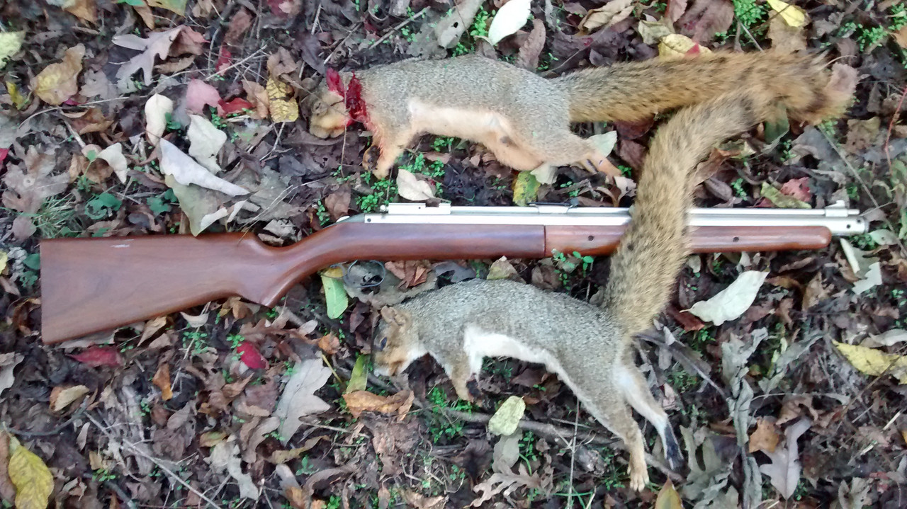

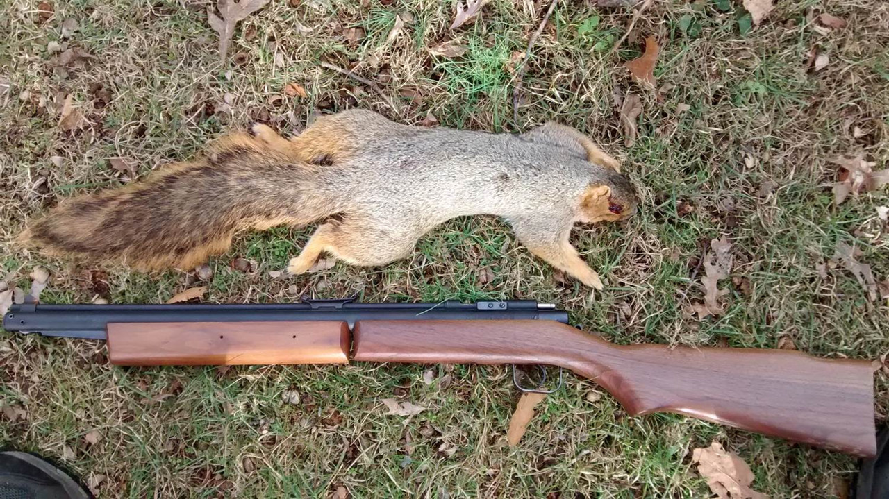

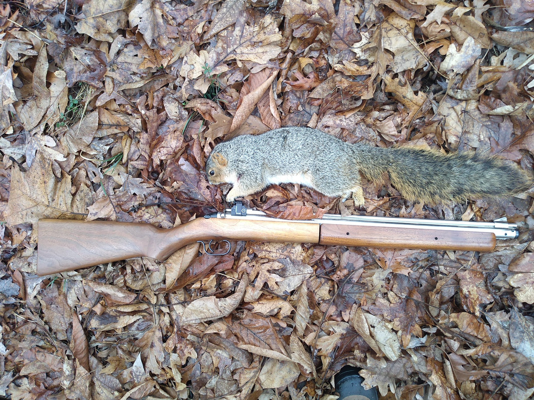

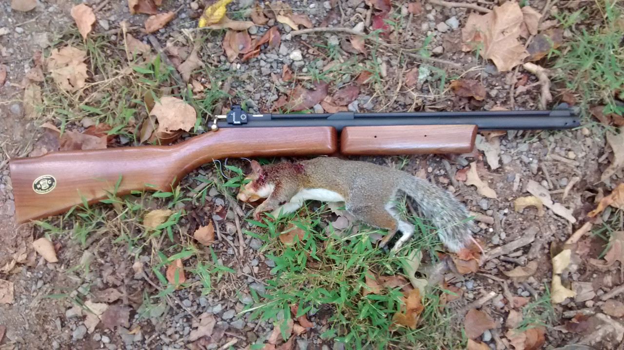

Re: Do you have a non-functional Benjamin or Sheridan rifle?
Yes, I've been a huge airgun guy pretty much my whole life. I also had a Daisy 880 and it was a decent gun. Mine had a metal receiver and pump arm. The problem with mine was that the stock became loose and would rock back and forth making it impossible to shoot accurately. Then eventually the seals went out. I had it repaired a while back by a supposedly reputable airgun smith who was supposed to replace the stock and reseal. When I got it back, he had simply glued the stock in place with what looked like liquid nails and he did reseal it but it has significantly less power than it originally had. oh well. it is extremely accurate now, so that's all I need it to be.
Back when I had that 880, one of my cousins had a sheridan rifle which seemed like a "real" gun. All metal and walnut, and tons of power. He could shoot through some pretty thick steel with those sheridan cylindrical pellets.
In 1992, I got the Benjamin 397P for Christmas and loved it. Then about 10 years later, after I was married and started working, I rediscovered my love for airguns and in particular the benjamin/sheridan guns. At that time you could still get them pretty cheap. I got the C9 on gun broker for $75, got the '51 silver for $100 at a gun show, and the rest I got for around $100 - $150. Some of which are now selling on ebay for $500!!!! so I'm glad to have built this collection before they got super popular about 5 years ago and skyrocketed in price.
the thing to watch out for on these guns is that crappy rear sight. They are shimmed in place which puts a lot of pressure on the solder connection between the barrel and pump tube. I've put the williams receiver sight on all of mine except for the '51 streak because I wasn't about to have that one drilled and tapped. all benjamin and sheridan guns after 1985 were drilled and tapped for that williams sight, but the earlier guns had to be drilled and tapped. I had Tim MacMurray D/T my 1977 silver streak as he is the man when it comes to these guns.
