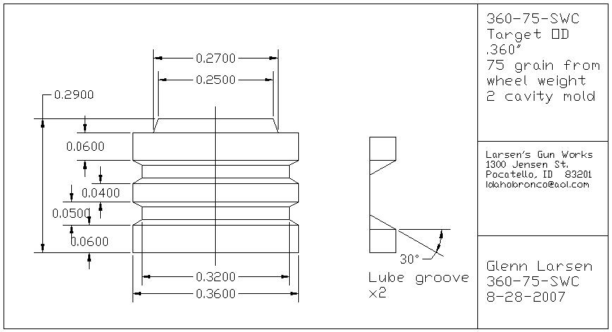

Posts: 15084
Here's a good one:
Stack 2 or 3 and have fun... :twisted:
My mould should be coming someday.
