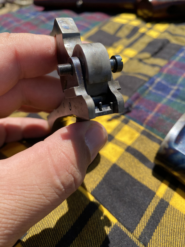

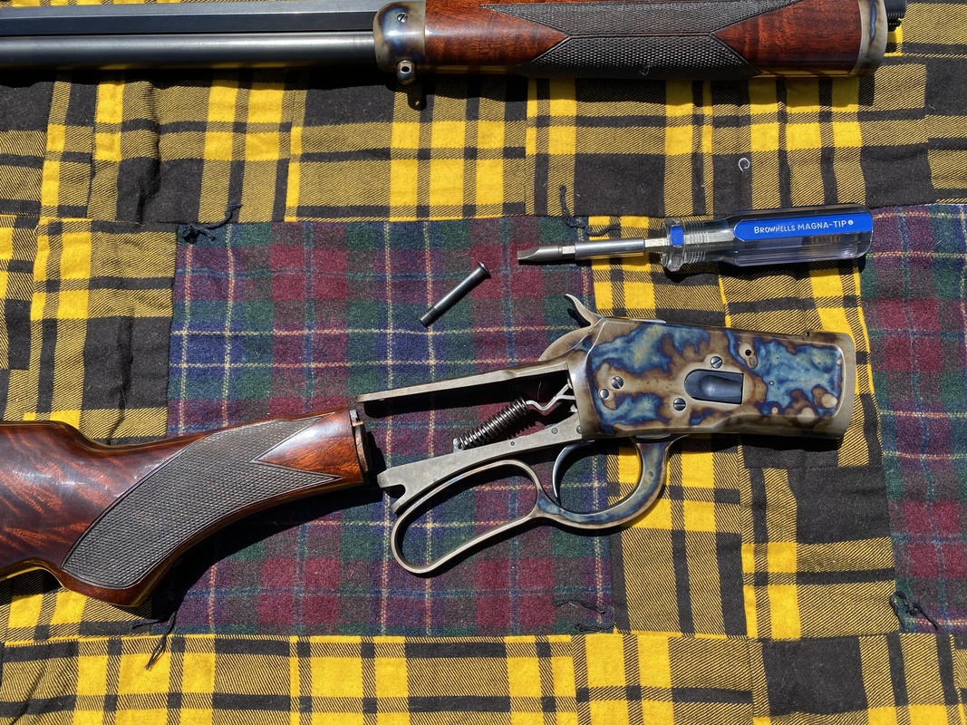

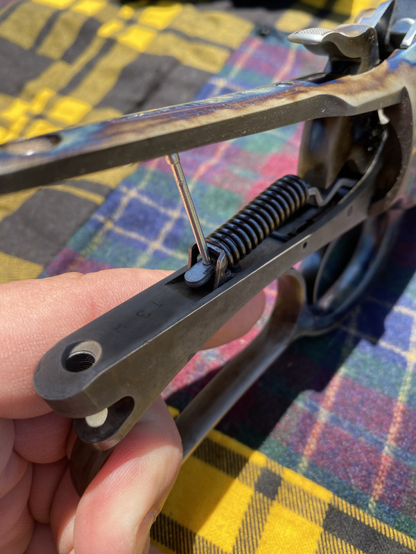

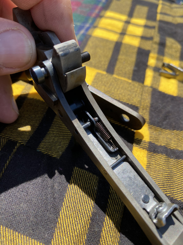

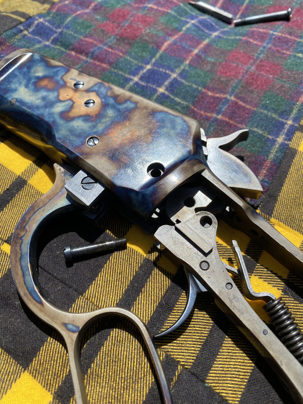

I have a Winchester 92 Deluxe takedown that's been converted to half cock by Turnbull. Originally, there is not only a rebounding hammer, but a firing pin block in the 92. You'll have to remove some parts of that, plus grind the firing pin to remove the blocking part. I don't know what parts were removed, as it was already converted when I got it.
As far as I know, they cut the half cock notch in the hammer deeper. Best I recall, they have a half cock shelf, but not a true notch. They shorten the lower leg on the strut so the hammer rests forward.
Here are some pictures of my rifle's guts that might be of help to you.
These pictures were taken on 2 different disassemblies.
