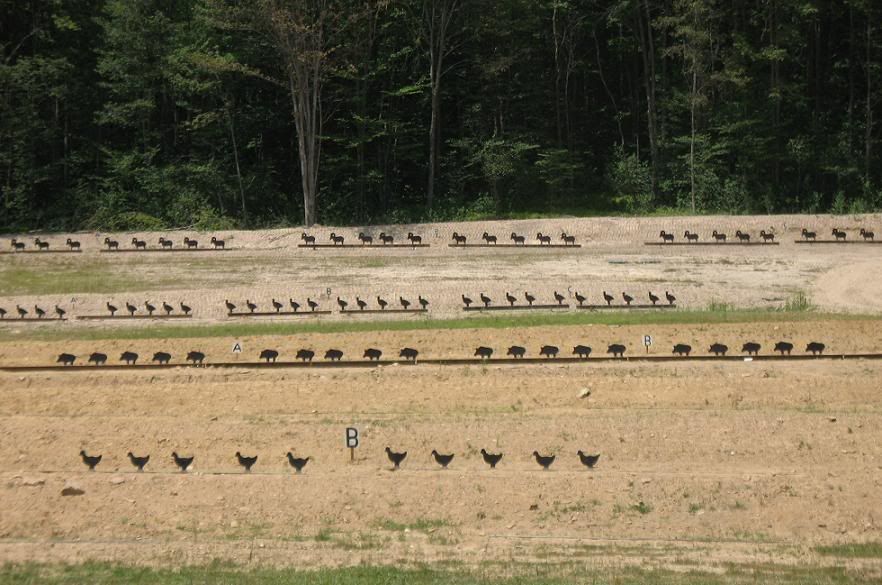

For those not familiar with NRA Cowboy Silhouette
w30wcf
Awesome!
Me thinks that there will be other trips to the NRA Cowboy Silhouette range with your vintage Winchester.......
