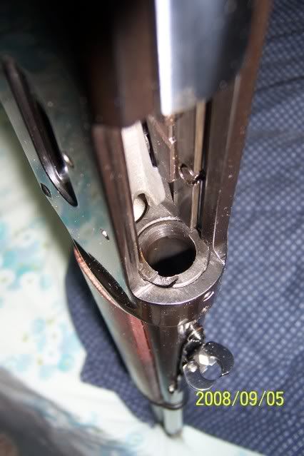

Picture: Extractor seems to be just clearing the grove. ( maybe that's why I have weak case
extraction) In picture the extractor mark is just barely visible where grove tappers off.
The Rim space ( 45 Colt ) has about .005 space on closing the bolt:
IE .007 feeler will still allow bolt to close ( but tight ) .005 still closes but snug.
Would this be considered head space?
My guess, turning the barrel about 5-10 degrees should not be a problem...

I don't see a problem with turning it in a little more. Get your self the tools and do it your self. Prop the gun upright and start putting some type of penetrating oil to soak down into the threads. Your gun isn't that old , so I don't think your going to have a problem backing out the barrel a little before turning it in. Use masking tape for marking a line on the receiver and on the barrel so when turning you know where you have to stop for alignment.

No more than what you will need to square the sights (probably less and 5 degrees I think) the headspace shouldn't be a problem. I like Ben's idea of taking the barrel off first than try to tighten it square. Clean both threads really well first.
As for tools, I'm betting you will need a real barrel vice with blocks and rosin and something for a receiver wrench to get this thing broke loose. It has been my experience that when you find one like this from the factory it's because they tightened it as tight as they could get it trying to square it up but just left it there rather than take the barrel back off and set the shoulder back to correct the problem. You may find that you will need to do that in order to get it to square. Ideally, it would be done in a lathe but if you are careful you can do it by hand filing with a safe side flat bastard or mill file.
