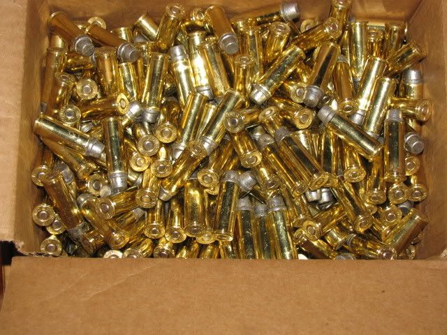

I enjoy reloading. Loaded about 500 rounds of .45 Colt for a friend today. New R-P brass, CCI 300 primers 6.5grains of RedDot and 255 grain semi-wadcutters.
Took about 2 hours on the Dillon, stopping every primer tube to check powder measure and fill primer tubes, was a great session, only had 3 flipped primers!
Now to get busy reloading the 120 rounds plus shotshell I shot over the weekend, then catch up on my .45 Colt ammo, .45 ACP, & .38 Specials!

No, those were a box of 1,000 I'd purchased something like 20+ years ago and decided that I wanted something lighter for my CAS loads, I'd tell ya who made 'em, but the box was just dust, & have no idea where I got them at this late date. In fact, I'd thought about melting them down on several ocassions, but when my hunting buddy said he'd bought a .45 Colt and wanted some 255grain SWCs, I figured, why not?Ysabel Kid wrote:Griff -
Did you cast those bullets yourself?
