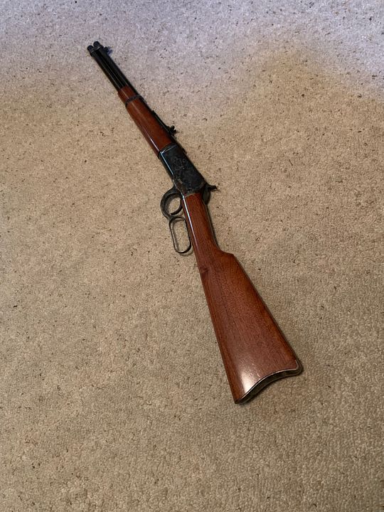

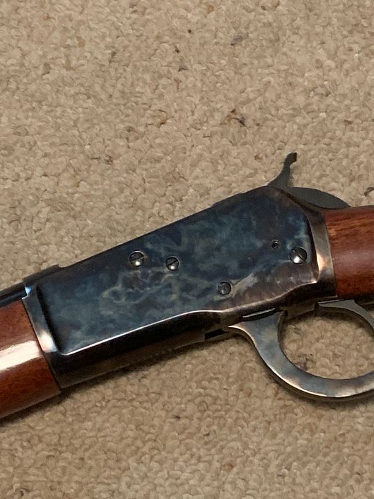

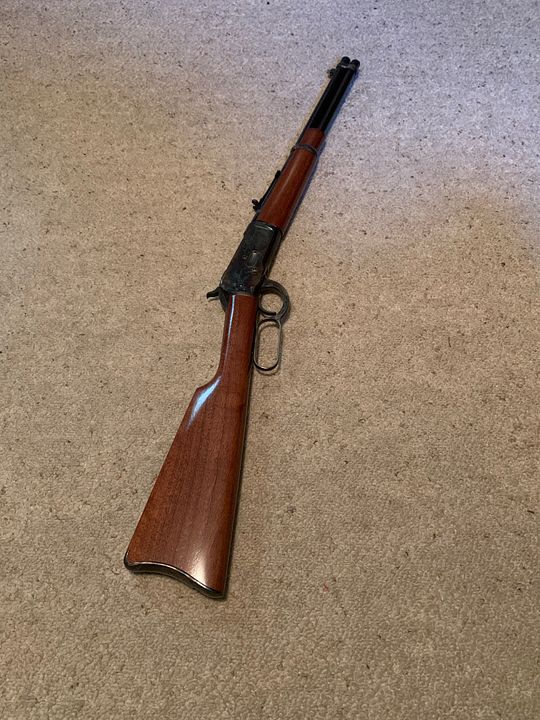

Here are some photos of the carbine:
I don’t really care for the saddle ring. The saddle ring stud was threaded into the receiver so I unscrewed it and screwed in a small allen key threaded plug.
