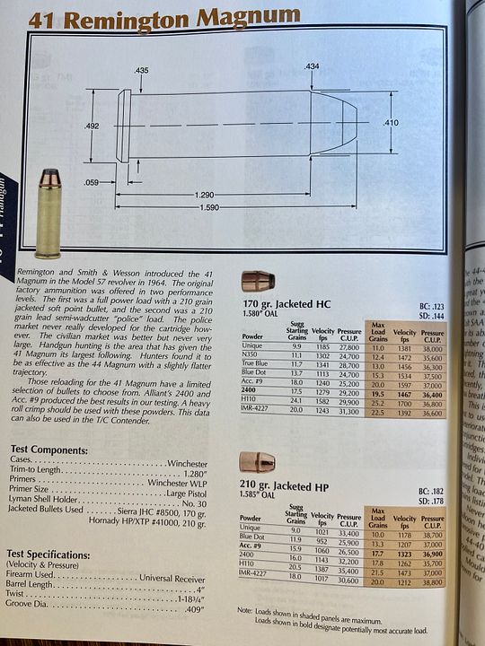

Brian Pearce did a Pet Loads article for .41 magnum in the February 2020 (#324) issue of Handloader magazine. I thought it was interesting that the majority of his potentially most accurate loads were in the mid-power range. I have a tremendous amount of respect for Brian's expertise and experience but I found a couple of his high end loads to be scary.

Page from Lyman's Cast Bullet Handbook. Sorry I cut the left side of the page a little short.

I think at least some of the reason for reducing powder charges lies in decisions made by lawyers.

Ran the data on the .41 Mag at 36K PSI with a 210, Hornady HP/XTP #41000. Lil' Gun had a 37 fps advantage to H110/Win 296/WC 820 (the last is I believe a military surplus powder but Jim, please correct me!). All 3 are the same except for when made and lot variations I suspect. Somehow I don't think the elk will notice the additional 37 fps (that was calculated out of a 7.5 inch barrel BTW.) H110/Win 296 is a little harder to ignite and needs some compression to work well as most everyone already knows. Lil' Gun ignites easier and burns a bit hotter. If Lil' Gun works good, then almost certainly Alliant 300 MP would also work good, and quite likely better, but it is not in the Quick Load data base because it has a dual coating of deterrents (ignition retardants) that renders it unpredictable to the Quick Load algorithm.
Also, this is only at 36 K PSI. A FA Model 83 in 41 Mag (they used to make them, not sure they do now?) would be much stronger. The Lil Gun load I calculated, and this is just predicted, was doing 1617 fps out of a 7.5 inch barrel at 100.6% fill! Smokin! And still some room!
I love this stuff!
-Tutt
I love this stuff!
-Tutt

P.S. Blue Dot came in around 1524 fps under similar criteria of 36K PSI but the fill was lower at about 93.5%. -T-
Re: Blue Dot and the .41 Magnum
The problem with Lil Gun in the .41 FA was it ate the throat very quickly. Freedom Arms did not recommend it.
