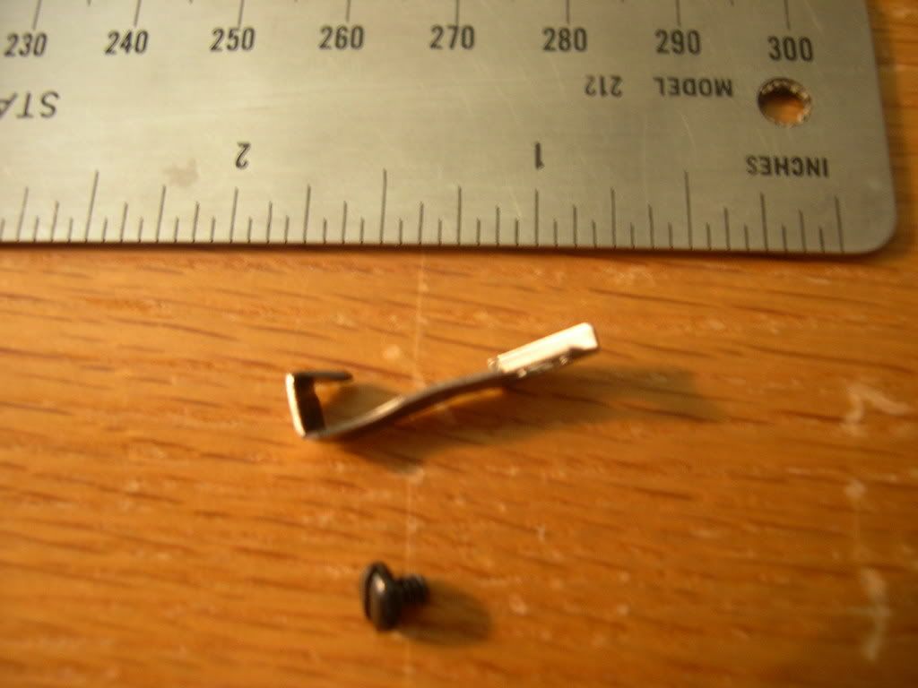

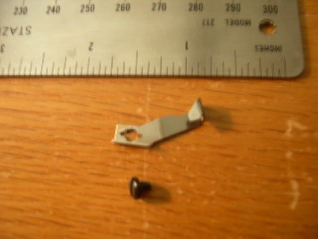

Depending on how comfortable you are tearing down you rifle you may want to remove the loading gate and look for this little jewel Image
It is a cartridge stop for the undersized 357mag cartridge (when used in the win 94 action) I have had one wear out and have replaced it. The front "face" or hook wore and broke off and so the cartridges would slip by, the would still cycle ok but you could not put another cartridge into the loading gate until all the existing cartridges were fired or racked out of the action. It screws to the lever and can be removed/attached through the loading gate space. Winchester has replacements for a few dollars last I checked.
The 357mag is the only 94 to need this part as far as I know. The 44mag is fat enough and the 30/30 is long enough not to need this.
hope this helps.
