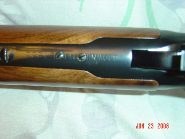

My first attempt at posting photos.ImageImage

That looks like a tang peep sight holes. The Peep sight would be in the back two screws. The screw 1/2" toward the hammer is the stock screw. When you drill for the tang sight you use the stock screw toward the butt and drill one toward the hammer which is what it looks like you have. They just stuck a screw in it to make it look good.

For some reason the previous owner drilled and tapped two holes rather than one. I'm looking at the Marbles and Lyman sites to see what sight would would fit the spacing. I'll probably make a few calls. I put plug screws in the holes just to cover them up. The open sights are too much of a challenge for my old eyes.
Re: Browning 1886
Looks like it's for a Marbles sight. I have one on My Marlin 95 that are less than an inch apart.

Thanks to all for the information. I've sent an e-mail to Marbles with the spacing of the holes from the upper tang screw and hopefully they have a sight that will fit.
Ron

I believe that you are on the right track. They appear to match those on my Browning 1895 which wears a Marble tang sight.

The Marble's phone system directed me to Brownells and the rep was very helpful in looking for a sight that would fit the existing holes. Nothing was found that would fit correctly for the 1886 so I will end up having to D/T another hole.

Dixie Gun Works used to have a tang sight with an extended (oval-like) front tang 'slot' for lack of a better term, allowing it to be used on guns with odd screw hole spacing. The front 'slot' was something like 3/8ths to 1/2 inch long, giving a little leeway when mounting it.
With two screw holes already tapped in the tang, I guess you have nothing to lose by tapping it again, since it's all gonna be covered up by the tang sight.
I think there's a 'modern' 1886-style sight for the tang-safety USRAC rifles/carbines that uses two screws in front of the tang safety. Maybe the previous owner bought one of these sights by mistake and installed it on your Browning.
