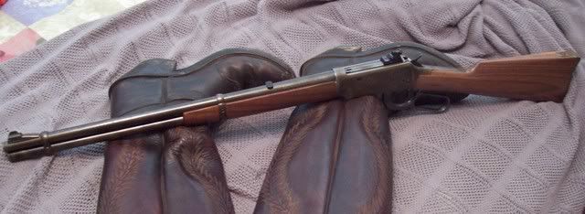

The nephew liked the sight picture of the Williams FP, but like me didn't like the chunk on the side of the receiver. I had a round-bottomed Williams I had picked up cheap on eBay a whille back and decided to see about putting it on the bolt.
I laid some emory over an uninstalled 94 bolt and made the bottom contour of the sight fit. I then took it to a better smith than myself for the drilling and tapping (I have better equipment now and may do the next one myself).
(Sorry about the horse stuff on the boot heel).
I took it out for a spin and found out the tall front sight really needs to be a little taller. I also found out the sight needed Lock-tite! (Already done, now).

Very nice! Is the sight the same width as the bolt? What model is it? I think I'd like to do that on my project too. Looks good.

I filed one of those flat also to mount on top of my 39A. That style Williams sight needs a tall front sight no matter what rifle it's on. The lyman receiver sights seem to be the least chunky . Looks great!

How does the side/side movement of the bolt affect accuracy/repeatability?

I'm w/your nephew, I don't like the stuff hangin' off the side on receiver sights. That's clean looking. Can you see over the hammer @ rest?

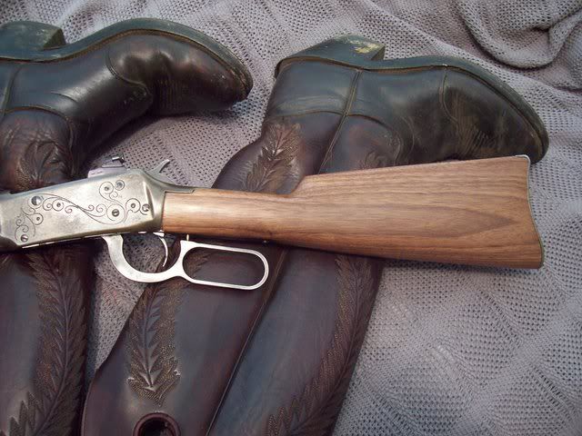

Where did the stock on that 94 come from, I mean is it a commemorative stock or from some model? One like it would look really neat on my 94AE Trapper.
How high of a front sight did it take to get it sighted in?

The stock came from eBAy. The seller has one running all the time:
http://cgi.ebay.com/ws/eBayISAPI.dll?Vi ... :IT&ih=019
It took quite a bit to get it fitted for some reason, but I came up with a nice piece of wood in the end.
You can see in the last picture the hammer does not interfere with the sight picture when not cocked. The sight is the same width as the bolt.
