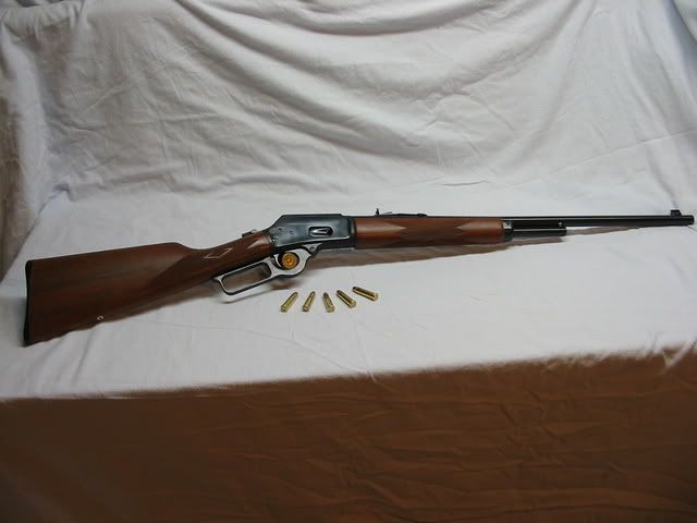

[img][img]http://i263.photobucket.com/albums/ii15 ... -20001.jpg[/img][/img] Sorry for the poor quality photo ,but here she is.

Nice looking Marlin, but you might want to let the hammer down on that rig.

Gihon, Yeah I failed to bring the hammer down to half cock :oops: , but at least the crossbolt safety is on.
