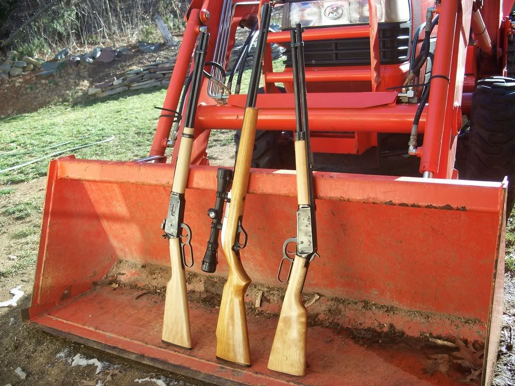

For your viewing pleasure:
L to R, my '05 .30-30 '94; my son's Marlin model 60 .22 (the dirty blond); my '70's vintage Sears model 54 (Win. 94) .30-30. All bereft of there original distasteful finishes and refinished au natural.
The newest 94 had a truly ugly dark purple/black/brown color that had no character whatsoever. The plastic (catylized lacquer?) coating was very difficult to remove. I was happy to see the nice, blond wood revealed. I refinished with Formby's Tung Oil Finish, 2 coats, which has made me happy on my daily carry .38.
The dirty blond model 60 was a cosmetic mess when I got it. My son Chas was dismayed when he saw me attack it with paint stripper and steel wool, but said "wow" when he saw the bare receiver against the blued barrel, and the beauty of the wood. This one got a coat of Minwax Natural Stain, and top coated with Birchwood Casey Tru-Oil.
The Sears 54 was in very good mechanical shape, but some knothead had let the original varnish start peeling, and drilled a half-depth hole in the side of the buttstock. It too has been beautified with the blond treatment, protected by Formby's, and a .30-30 case head neatly filled the mysterious hole. It normally wears a tang sight, but I had set it aside during the refinish.
Those look really good homefront. I am growing more and more fond of the blondes. They provide a nice contrast. I recently did my Stevens 311 as a Blondie too and will get some pics up.
jbm1968
Posts: 234
Post by jbm1968 »
Very Good Looking Blondes!
Jonathan
Soldier
Good job. I refinished my first '94 and it was blonde like yours. I was like 13 years old. Can't tell you much about the oil I used other than it was some form of linseed.
Posts: 16953
I like it.
sweet!
Posts: 30502
Without looking, I would have had my doubts. But: Those are truly beautiful, Sir!

Thank you, gentlemen!
I'm tempted to give my Marlin CB the same treatment, because the grain is so beautiful and the stain a little dark for my taste.
I did the same on 3 different Savage .22 autos (for my dad, my daughter, and me) and was pleasantly surprised at the curly/wavy wood underneath the bland stain.
I'll to do the same with my latest Marlin .357 this week - will add pics in a few days.

Those blondes are nothing to joke about :lol: nice looking though

She'll be ok as long as she knows the blond is second fiddle!
I know I was taking a chance that the forearm and butt stock would not match well enough after the stain/varnish was removed - I was lucky.

Homefront...VERY nice. I have done several of my rifles in a similar manner...very little or NO stain. I'm surprised not more folks like the light wood. My last refinish was a 99E with an absolutely gross finish on the stock...almost had a green tint to it...yuck. I stripped it down to bare wood, sanded (all but the impressed checkering...lol), and then used 2 coats of yellow shellac, which works as a great wood filler when cut about 50/50 with spirits, and finished with three coats or so of satin spray-on poly. Two old model 100s were redone in a similar manner and the walnut found under all that stain and old finish is gorgeous. One is still looking great after almost 20yrs. I also absolutely HAD to have a blonde Sako .270 as soon as I laid my eyes on it's light stock. Yup, even my wife knows that blondes do it for me!
