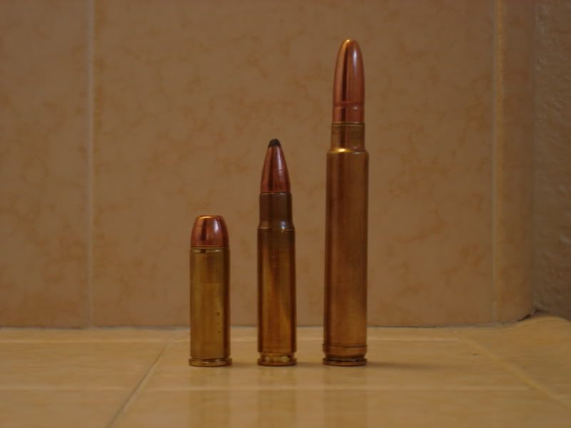

I would submit that the reason the 416 Rem kicks so hard as compared to the 416 Rigby or 505 Gibbs is related in some way to case capacity, pressure and how slow a powder you can use. The huge cases of the 416 Rigby and 505 Gibbs allow the use of very slow burning powders that create more of a "push" then a hard "snap".

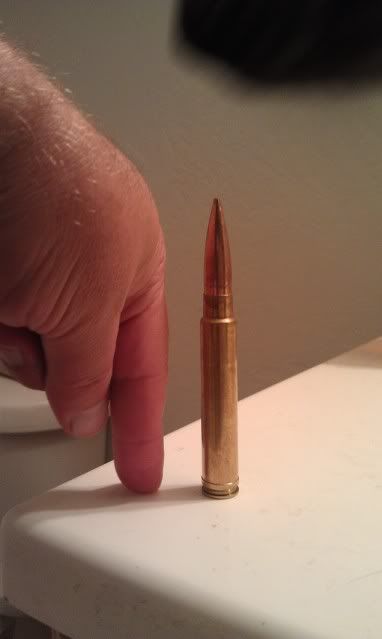

I have to say I'm real partial to my 375 H&H AI on my CZ action (which has almost no comparison for strength) that allows me to shoot a 350 grain BT bullet at 2500 fps that has a BC in the seven hundreds and stays supersonic past 1500 yards at sea level. A very hard combination to beat for flat trajectory and incredible terminal performance even at very long range (better than all of the 458 bullets we are discussing in fact). I'm able to seat the bullet WAY out because of the wonderful design of the CZ action and extra long chamber which allows a lot more case capacity. You need a copy of Quickload on your computer to do this right. The black in the picture is my cat who just HAD to get involved!
And here's a pic with a 350 Woodleigh RN bullet seated far out beyond the crimp as compared to a 358 Win and 454 Casull.
We now return to our regularly scheduled programing.
-Tutt
