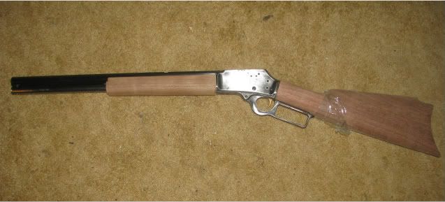

Well, I located and finalized the deal on my next project gun, a pre-safety Marlin 1894 Competition Cowboy. The rifle is a rusted hunk of junk, I was offered right here in my hometown! Apparently this .44Mag was left outside for a coupla years and didn't suffer from over-attention. I pick up the gun the 2nd week in May.

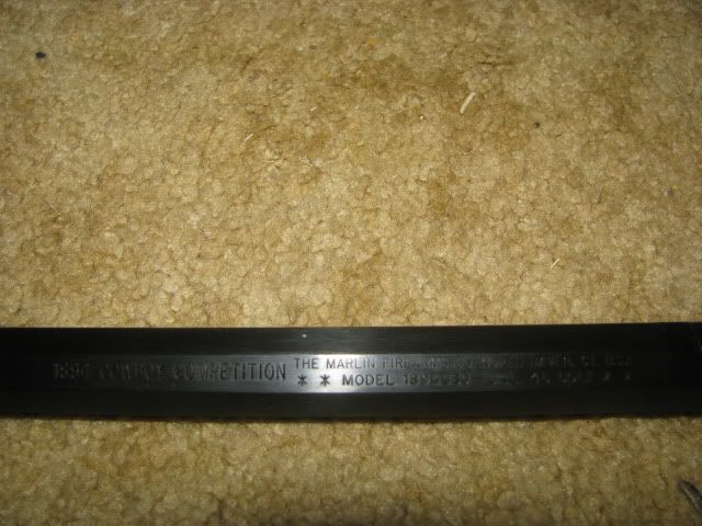

The rifle is coming with a new Marlin 20" Cowboy Competition .45 Colt barrel. I have not seen how Marlin holds the front of their mag tube under the barrel, except on my mdl 375, which uses a simple block dovetailed to the barrel with a screw thru the end cap. Are the octagon barrels done similarily?
In addition to refinishing the metal, a new stock & crescent buttplate will be fitted along with conversion to .45Colt/Cowboy45Special. To really see how amazing this dual "chambering" is watch the video on Marauder's website where the modifications necessary are described. Widderm'AJ'ic
The impetus for this project came from my desire to actually compete in SASS' "Wild Bunch" matches. Actually compete, insteada just playin' around as I do in cowboy matches. The 1911 is a gun I've shot, carried and competed with for 40 years... As the rules have a power factor, minimum bullet weight and all 1911s must be 45ACP, plus the mods allowed are really stringent, I see that as a huge equalizer. With the shotgun requirement of an 1897 pump, (original or clone), your rifle is about the only to "game" it!
Since AJ's C45S is essentially a 45ACP with a 45Colt rim, I'm figuring to switch calibers on the reloading bench will only need the shellplate changed on my Dillon. Same boolits and powder charge, should yield good results. 815fps outta the 1911 will make the power factor, so while I could drop the powder needed to make the PF outta the rifle, an increase to ~1000fps outta the rifle shouldn't impact recoil or shot to shot speeds. And since it requires at least a .40 rifle and the same minimum PF, even if some do drop their rifle ammo down the minimum, gun handling and accuracy should prevail!
I'm considering simply bluing the gun, or going to CCH on the receiver, bolt, floor plate, forend cap & buttplate.

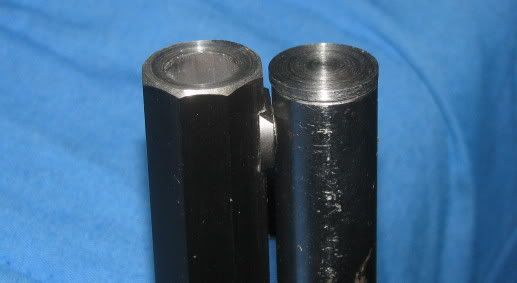

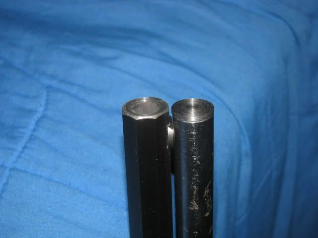

1 - Can someone with one of the octagon Cowboy Competition models post a pic of the front magazine hanger?

Re: New Levergun Project! 1894 Marlin
Here you go. It's just the little dovetailed block in the barrel at the front.
This is the closest pic I've got:
As for refinishing you can see mine is cc finished on the receiver, lever, and trigger plate (lower tang).
Hope this helps some.

Yep, dovetailed hanger on the bottom of the barrel, and yer gonna have to re-work the mag tube to match. I suggest getting the holes right (one side of the hole is big, the other smaller, as it slips over the hanger and is caught with a screw from the bottom), then clip off the other end of the tube to length where it fits into the receiver and chamfer the end on the inside just a tiny bit. Yer CC barrel is 20", the .44 manglem is 22"......
I had Bill English cut one of my .45 CB-L barrels to 16.25". It holds ten C45S rounds.

Thanks Joe. That does indeed look like how my mdl 375 is attached. And thanks for CCH info... don't want mine to look "just like" 'em, but close enough to make 'em think, "...what'd he do with safety?" :twisted:
adirondakjack wrote:...yer gonna have to re-work the mag tube to match. I suggest getting the holes right (one side of the hole is big, the other smaller, as it slips over the hanger and is caught with a screw from the bottom), then clip off the other end of the tube to length where it fits into the receiver and chamfer the end on the inside just a tiny bit. Yer CC barrel is 20", the .44 manglem is 22"......
Thanks for the reminder on the mag tubes. What's the OAL on those cartridges as I might need to adjust to accommodate longer boolits.

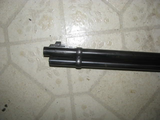

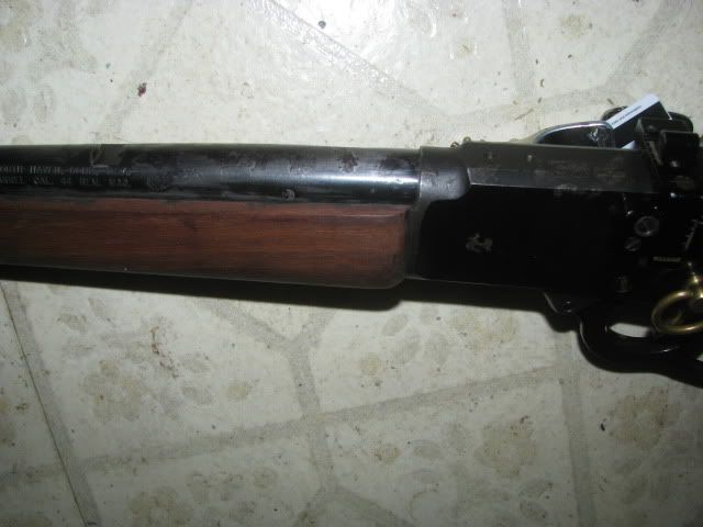

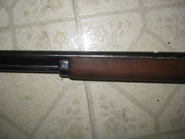

Well, to the rifle: pics above were from the seller, (who, I must say is quite the nice gentleman and isn't the one that abused this rifle. He got it with the intent to convert just as I'm doin', but decided it was too big a project). When I posted that I was looking for one, I fully expected to be contacted by someone across the country... was really surprised to find that he was right here in town! And a visitor on this forum from time to time. I promised I'd document the build and keep photos of its progress.
So, in the beginning there was an abused and neglected .44Mag Marlin 1894:
And, a new .45 Colt Cowboy Competition barrel.

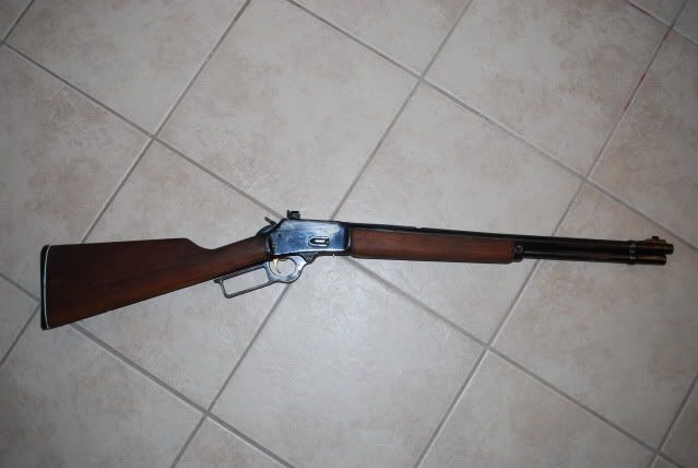

Griff, I have a Cowboy Limited CB 45 that I could take a picture of the rear sight if need be. Just let me know.

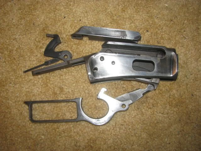

Well, never one to delay tearin' something apart:
Disassembly is done. Well... almost, still gotta get the barrel off. Tried the bench vise and wood block method... it's way tight! Might just have a pro do it, and save any damage to the receiver... once that's done, it's sandpaper and crocus cloth and polishing compound.
Joe, the peep is a Williams, marked on the bottom, "94 36". While it looks something like the FP in your pic, it's click adjustable for both windage and elevation.
OS/Kim, all the Marble's rear sights I see now use the double row elevator. Not my cup of tea. But, from what I can tell, the Marlin uses a single elevator same as the other mdl 1894s.
OS, only one levergun with a "handle". Pics can be seen here: Re: marlin 375 serial # ?.

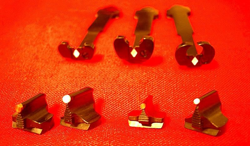

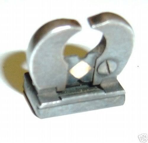

Marlin uses the marbles tall semi. It's the one in the middle. They use the 3/32" brass for the front. the one on the left.
Keep in mind if you color-case it that helps cover any pits. here's one Mike hunter just finished for one of my customers. The forend cap was cased too.

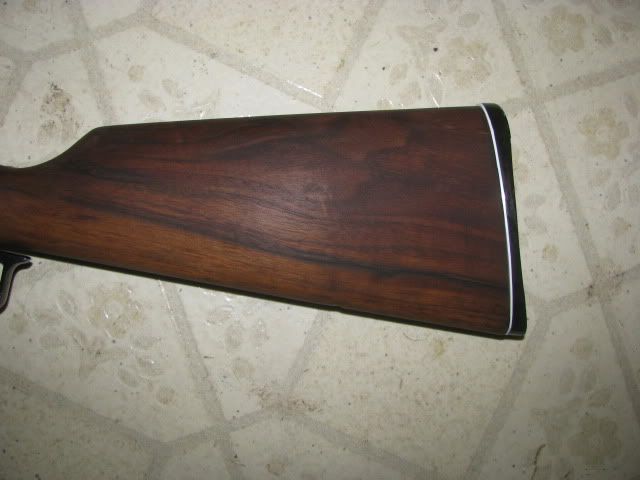

Here's a Cowboy with crescent buttplate.

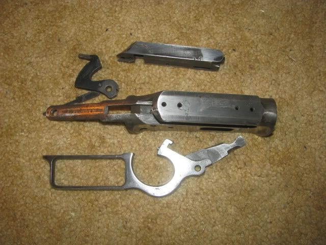

Posts: 21466
Nate,

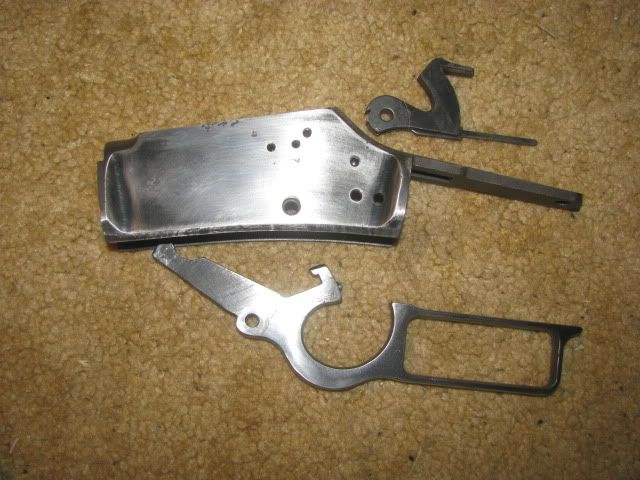

Don't think mine will turn out anywhere that nice... But, it's starting out a little rough (hey! it's my excuse)!
The barrel is off... (anyone want a .44Mag barrel? Be advised, it's very pitted on the outside... many pipe wrench marks!!!! It was tight!)
After a little sanding, it's looking better, but the pits are pretty bad:
Anyone have a Bisley hammer... I think I'd like a wider spur on this Marlin. On the agenda for tomorrow? Cut out the forend cap for the octagon barrel... Yeehaw... dremel here I come!

Sent those parts to Mike and most of those pits will disappear. The one pictured above was about the same.
Sent him an email, need to cut the barrel to 16-½", the mag tube and then re-blue it also. BTW, my barrel contacts the receiver about a ½ a flat off from level... is that too far to tighten, or should I figure on having the surface machined a little to make it closer?

Nate Kiowa Jones wrote:Griff,

Griff wrote:OS/Kim, all the Marble's rear sights I see now use the double row elevator. Not my cup of tea.
What I'd like is a Williams FP base using the 'aperture' from a Marble's Bullseye rear sight. If I were a good machinist (and had a milling machine) I'd make one by drilling out and threading the dovetail-base of the 'fixed' version of the Marbles:
Image + Image = ???
Posts: 21466
Image + Image = ???
I'm a traditionalist... and SASS rules don't allow any of those sights. Since this is going to be a competition rifle in SASS sanctioned matches... I kinda gotta go with their guidelines... and they also happen to fit my idea of what I like. If I knew of a place to get a reproduction of this sight:
I'd have two! to go on my rifles with tang sights.
Since that's not likely, for this particular rifle I'm looking for another of these:
It's a quick sight to get on target... I think it, in combination with one of Nate's Grabber sights he pictured above will be the combo I want to go with.

kimwcook wrote:Griff, I have a Cowboy Limited CB 45 that I could take a picture of the rear sight if need be. Just let me know.
Kim,
That would be super.

Well, the non-fitting stock has been returned and I'm waiting on the arrival of the correct stock and a matching forend from Precision.
The flap over my proposed hammer modification reached the highest levels of SASS, and the result is: they don't want to entertain the notion. Sorta like opening Pandora's box, you just never know what you'll be letting out!
So... since I have all this time on my hands and was thinking about this today, (traffic is light on the 2-lanes of MS & TN and my A/C is broke), it dawned on me that my hammer is undercut for a slide-on spur extension. SO... why not make the Bisley spur a removeable extension!
End of problem! Now all I need is a machinist to do some itty-bitty work!

The project 1894 came home today after having the barrel shortened to 17", a new dovetail cut for the mag tube, barrel indexed & headspaced... and the barrel crowned. 8)
Threw the stock blanks on it, and viola! Balances wonderfully, right in front of the lever pivot screw... throws up to the shoulder like it was returning to the womb... uhhhh, I think I'm going to love this rifle!
Ain't sure the nice crown job will show in the pic, but it's concaved and the outside is nicely radiused!
Now, to stock up on sandpaper! :P :lol:

Griff, I don't know how I missed you asking for the pic of my 94 barrel sight. I'll take a look at it right now and see if anyone's posted one that looks like it.
I forgot I put a tang sight on it and took the barrel sight off. I don't know right off the top of my head where it's at. I'll look for it in the next couple of days.

Kim, I'd like that, thanks. Until I get the sights... I'm holding off getting the front dovetail cut. I'll get the hammer mod done at the same time...

WOW! Been fitting the stock and forend... that inletting is tedious work! I've done one Winchester 94 that was 95% inletted... this one is like 96 or 98%... but whereas the Winchester just needed the front edge cut so that the tang went all the way back, this one has the tang cut just a 1/8" short! Those little curved at the end of the hammer slot are tough to get right! :( Sadly, the first forend I tried was about that same 1/8" too short! The second is about that much too long! Rasping down the ends on the forend is tough to keep straight! Either that or my eye to hand control is worse off than I thought! :shock:
Put all the pieces back in 'er... and arrrggghhh! The magazine tube was drilled off-center. The gunsmith made a new plug; and didn't drill it quite right... too shallow for the stud it screws into... so the mag tube sits too far off the barrel, the forend cap won't line up unless I really bend the tube upward in the middle... NOT the right way to do this. I think that between that, the homemade plug, and the fact that the mag tube was really pitted when I got the rifle; a new plug & mag tube are in order.
But, on the plus side, 17" was the absolutely correct length to cut the barrel, it'll hold 12 of AJ's little Cowboy45Specials or nine 45 Colts, both with a 185grain WFN. With just a ¼" more, it'd hold 10 45Colts! :P Maybe cutting down the spring a bit more (plenty of tension with about 8" of spring stickin' beyond the tube. It'll feed one C45S, but with any in the mag, there's something binding it up. Or something is pushing the rim of the second round out into the frame, and blocking the carrier from coming back up. Not good! :x Looks like I'll be learning more about the Marlin 1894 than I first thought! :P I'll have to study on Widowmaker Hill's conversion a bit more... (note: this is an unmodified .44Magnum with a .45Colt barrel installed. So, it ain't like I was expecting to work before I made the changes WH outlines in his "Widowm'aj'ic Special" mod for the Marlin 1894. Which'll be engraved on the barrel once all the final work is done. Headspace is perfect @ .0025". Should still be fine even after it warms up!
I'm going to have to study up on how to correct that. But, oh boy, does this little baby balance nicely! :D :D Maybe a new mainspring, as the insides are polished up nicely and it's one smooth baby! Since the run I normally do has all but dried up, I've been running around TX and LA for the last two weeks, no issues about taking the baby with me and working on it at night! Hopin' to get back to my good payin' run after the first of the year... if not before!

Ok, think I've found the problem with the magazine. If anyone has a 1894 Cowboy I wonder if they could tell me if my magazine stud is in too shallow of a dovetail? Or, to put another way, is the magazine being held too far away from the bottom of the barrel?
Here's a pic of the dovetail as cut:
Since I can't recut the dovetail... or make it deeper (?), if it's too shallow, I guess I'll have to remove some metal off the stud.

Ya may have to use a washer type shim on the mag tube stud Jam a piece of cardboard or something between the mag tube and barrel to figure out how thick a washer ya need on the stud to get the tube further from the BBL.
Certified gun nut
Posts: 21466
adirondakjack wrote:Ya may have to use a washer type shim on the mag tube stud Jam a piece of cardboard or something between the mag tube and barrel to figure out how thick a washer ya need on the stud to get the tube further from the BBL.
Actually, I think the gap at the muzzle is too large.

Here is a pic of the magazine tube hanger on my recently acquired Marlin 94 CB:
SHASTA
Posts: 21466
Thank you Shasta... yep, he cut the dovetail too shallow. The stud portion appears to be flush with the bottom of the barrel... so that mag almost touches... now... THAT, I don't know if it can be corrected without a new barrel?
