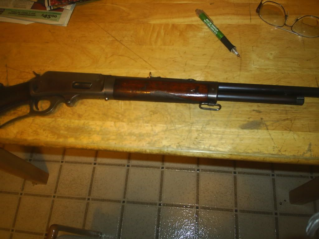

[img][img]http://i268.photobucket.com/albums/jj37 ... ure185.jpg[/img]
Here is a pic of the Marlin 1893 with the short forearm in my collection.
It measures 6 3/4 " in length wood to wood. If you go to you Brophy
book on Marlin firearms on pgs 573 574 & 575 the author discusses
the special lightweights on models 1893 & 1895. I hope this helps clear up
the confusion.
