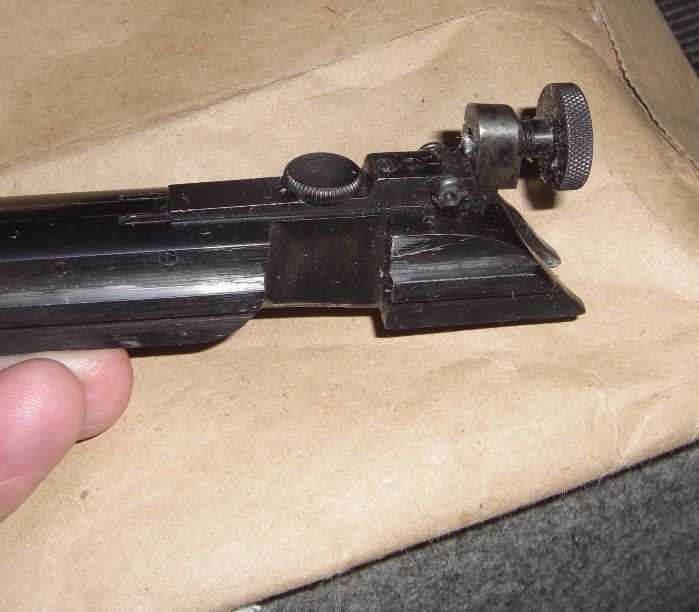

I got that bought reasonable enough, after I mount the bolt peep the big question is will I put it on my table at the next gun show.

The 98A appears to be incomplete and parts are very expensive and difficult to find. Overall, though, the rifle was a fair buy.
RANisbet
- Posts: 130
- Joined: Wed Jan 14, 2009 2:37 pm
- Location: Redstone Arsenal, Alabama
Re: Winchester Deluxe 71 going fast on Gunbroker.
Sight Problem Validated.
I reverse engineered the 98A sight a short while back, and have helped a number of folks by making replacement or repair parts. Just a hobby thing, not a business.
Here is what I see with that model 71 rifle sight:
a] The back end of the sight base has been broken off. It should have a piece that has half of a dovetail.
b] The Windage Piece is missing. It is the part that holds the Aperture.
c] The special screw and nut that hold the Windage Piece on the sight base is missing.
d] The Aperture Piece is missing.
e & f] The Elevation Stop screw and the Elevation Spring screw may be missing.
g] The cross pin appears to have been "mangled.
h] The front sight looks like an after market replacement.
There may be more problems, but I can't tell from the limited pictures.
