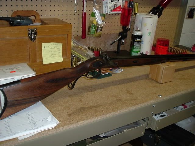

Re: OT-Muzzlestuffer consistant accuracy?
I bought this rifle in the mid '70s, it was my 2nd muzzleloader. I bought it at the Log Cabin Shop, for about $289, IIRC. It's a Uberti copy of a J&S Hawken that resides in a Sante Fe Museum. It's a .53 caliber.
For target shooting of the formal kind, NMRLA type, 50 & 100 yards will be the norm. for all 50 yard shooting I've used 50 grains of 2F and a .526 ball with .010 pillow ticking for patches... it generally will yield a ragged hole group of 5 shots. @ 100 yards, it opens up a little but remains inside 1-½" with 85 grains of 2F and that same .526 ball. For ranges beyond 100 yards, and hunting, I use a .520 ball and a .015 patch in front of 100 grains of 2F. Groups open to about 2" @ 100 yards... but, remain consistent to about 200 yards.
At the range I frequented in CA there was a manhole cover set at 500 yards... I used to make my range fee for the day betting that I could pick up my rifle, load, fire and hit that target with the first shot. I never lost that bet once I knew what bush to aim at.
Oh yeah, the barrel on my Uberti is a 1:66 twist. It is the rifle I'm shooting in my avatar, during which match I hit 6 of 7 shots @ 200 yards using a .526 ball with no patch during the early evening, as the sun was setting; shooting into the sun, and the accumulation of smoke you see in my avatar.
I basically have the same rifle however mine is a LH flintlock. That rifle will shoot heavy conicals very well. I do not care for the REAL bullets, never could get them to shoot very well. However I cast a large Lyman, and an RCBS Hotchkiss heavy(525 grains), and these bullets shoot great from the Lyman, and my other rifles.
