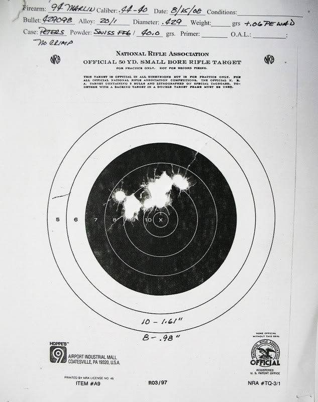

Of the calibers mentioned, I only have the .44 W.C.F. in an original Winchester '73 and a .44-40 Marlin Cowboy Ltd. As you can tell, I'm partial to that caliber.
Here's a 10 shot 50 yard group fired with a full 40 grs. of blackpowder and the Lyman 427098 bullet (.429" dia.).
And speaking of 300 yards.....here's six shots @ 300 meters (327 yards) with black powder
After getting the proper elevation (left 2 shots) I then clicked 2 moa right elevation to put the bullets closer to the center.
