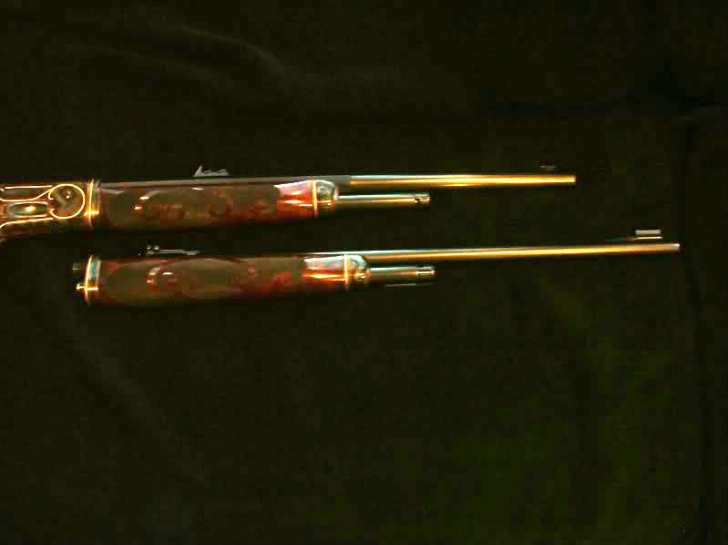

I have shot a turnball winchester model 71 takedown
2 barrel set in 348 and 450 alaskan...
what a shooter!
The owner is a member here....
I'll let him tell you about it.
what a shooter!

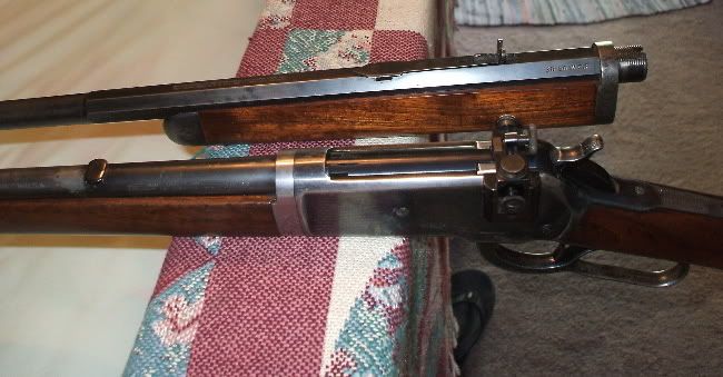

You can do it as long as the cartridges share the parent case head I believe or are at least very, very close to each other. For example, you should be able to have built a Winchester 94 in 38-55 and 25-35 in a two barrel set. As Rihmfire noted previously, I have a two barrel 71 in 348 and 450 Alaskan. The two share the same parent case ... the 50-110.
I have a really crappy dark picture of the two barrels together ...
I'd attend the Ysabel Kid school of photography, but then my feet would start showing up in them.
