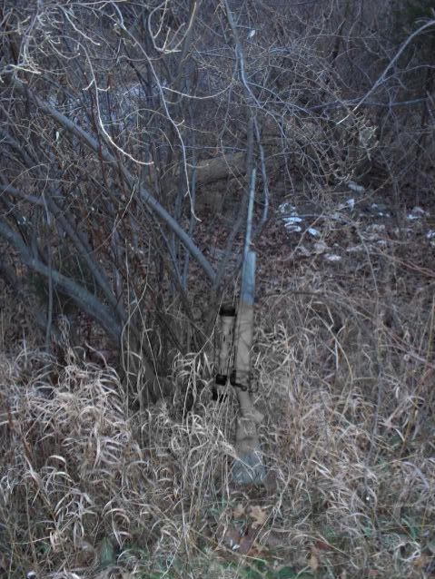

Well I finnaly got around to painting my new coyote rifle. Man I love krylon cammo paint.
The rifle is a Stevens 200 in .223Rem this gun shold make a great walking varmint rifle.
Of course my photo skills leave a bit to be desired the flash made it apear a bit on the white side. I used their cammo black, brown, OD green, and tan. I used grass as the over lay. I wiped down the entire gun with windex to remove any oils. Then I primed with the tan let it sit for a few hours then did stripes with the green, black, and brown. I let it cure for a couple of days then layed wild long grass over it and sprayed with the tan.

Uh, where is the rifle???? :)

Old Savage wrote:Uh, where is the rifle???? :)
:lol: :lol: :lol:
Fred I emailed those pic's to my SoCal yote hunting partner his advice was not to set the rifle down in the brush when I take care of business :wink: I may not find it again. :D

This is a rather simple thing to do. The only supplies you need are masking tape, Windex, and 1 each of the Krylon cammo spray paint 1 black, 1 brown, 1 green, 1 tan.
To start wipe the entire gun down with Windex this removes all the oils that would keep the paint from sticking. Mask all parts of the gun that you dont want painted. In this case I masked off the triger area the slingswivel studs the tang and saftey I removed the bolt and taped off the whole area to make sure that paint didnt get into this are and the chamber but you could leave it in and just mask over the bolt body. I also masked off the lenses on the scope the variable power adjustment ring and taped off the muzzel.
After the gun was preped I suspended the rifle from one of the studs in the basement and gave it an even coat of the tan as a primer and let it dry for 30min I repeated this twice more so that it had a good base coat before I started putting on the other colors. After the last prime coat I let it dry over night.
The next day I started in with the brown, black, and green I sprayed ruffly three inch wide strips green then brown then black( but you could do it any order you want) starting at one end and worked all the way down the gun (vertical stripes when the gun is in a firing position) dont worry about making it pretty at this point over spray is no big deal. After This step I let it dry for 2 days to let the paint cure. The last step is the easyest I want out in the yard and pulled several handfulls of long grass stalks layed the rifle on a sheet of plywood I then layed the grass over the rifle from muzzle to but. Then take the can of tan paint holding about 12'' away and spray the gun in one sweeping motion from muzzel to butt let sit for 20 minutes flip the rifle over to the other side and repeat. The grass creats a shadow effect by keeping the tan from covering the under lying colors.
You can use what ever you want for the overlay on the enfield I used tomato bush branches and used black paint as the final instead of the tan.
Enjoy
When I get the next gun done I will post step by step pic's to show what I am talking about.

Well finally got off my but and took some outdoor pics.
It blends into the twigs and brush well IMHO.
Here is a cool efect I only did one part of the pic in black and white centered on the reciever.
Here it is from a distance. It doesnt blend in with the grass as well as I would have liked. I will have to take some pics when the sun is out to see how it is in better light.
Posts: 7796
Re: OT What happens when you mix a rifle with Krylon
Better not walk far from that one. POOF! Where did it go?
