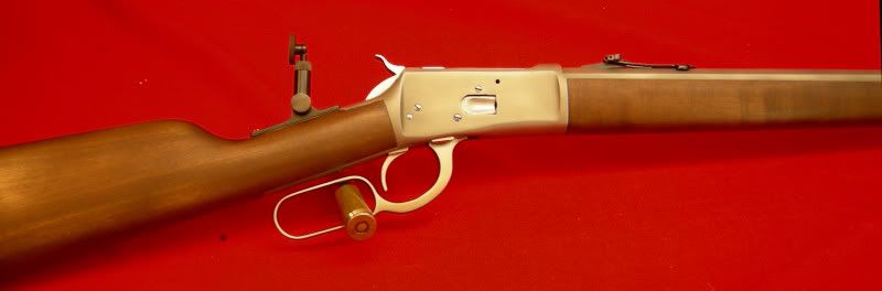

Here's some bead blasted Stainless 92's.

Re: Reproduction Model 92s by Rossi
Nate,
What type of bead blasting medium do you use. I FINALLY got my 44 back and I want to blast it. Plus it gives me the excuse to by some blasting equipment.
But Honey, I needed it?!?
That tang sight looks great on that bead blasted rifle; a lot better than that Williams (?) on the carbine. I wonder if the tang sight could be electroless nickle plated to look like the bead blasted stainless . . .
- Old Ironsights
- Posts: 15083
Having used both now, I DEFINATELY prefer the reciever sight. Don't care how it looks.Rick-F wrote:That tang sight looks great on that bead blasted rifle; a lot better than that Williams (?) on the carbine. I wonder if the tang sight could be electroless nickle plated to look like the bead blasted stainless . . .
Phil Miller
- Posts: 6
- Joined: Tue Dec 02, 2008 6:43 pm
- Location: Southern Indiana
O I,
Did you think the tang mounted sight was in the way? I think they look nicer than the receiver mounted. I'm still using the original sights but may go to a receiver sight in the future since these 48 year old peeps don't see 20/15 any more. I can't see putting a scope on it either although I do use one on my Encore muzzleloader.
Phil
Phil
- Old Ironsights
- Posts: 15083
I have a tang sight on my 1886 and the reciever on my 1892. The Tang sight is most certainly in the way/makes me change my preferred grip.
Unfortunate, as it really does look better and gives you a longer sight plane.
Old Ironsights wrote: Having used both now, I DEFINATELY prefer the reciever sight. Don't care how it looks.
Oh, I have no doubt the reciever sight is the more accurate sight. I was just referring the "period" look . . . but there was not much bead blasted stainless steel found on the originals-- so I guess my point is moot.
