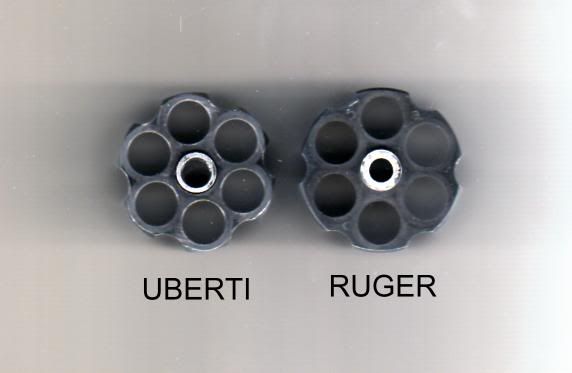

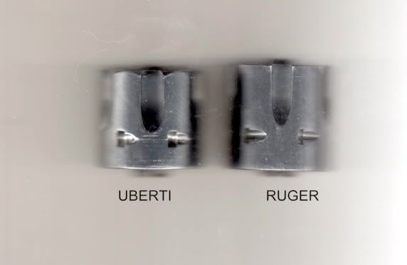

No +P ammo for these guys. The Uberti SAs are Colt copies and as such just don't have the metal in the cylinders or frames to handle the pressures of the +P loads.Tennessee Hayre wrote:By the way , Would it be safe to fire (+P ammo) in this revolver and what would be the best all around game round.
My max is 9.0 grs Unique under a 255gr to 270gr Keith SWC. There are many powders and bullets that can duplicate this, but I love the K.I.S.S. principle.
You will find when shooting your Uberti that it feels totally different from your Ruger. Ruger's grip frame is redesigned from the original and changes the balance of the revolver a lot.
If your Ruger is a .45 Colt I'd keep the +P stuff for that and use the standard loads in the Uberti.
